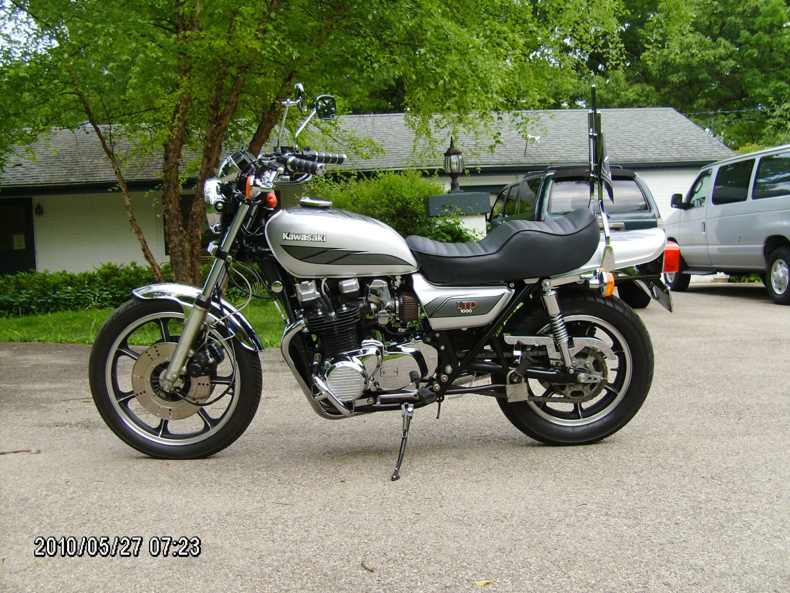

I have a 1980 LTD 1000, & would like to know if I can use the discs from a 1978 Z1R 1000, that have the double drilled holes, without having to do any modifications ?

yes they will fit,is the pattern drilled in rotors any differant? B)

Thats a nice looking bike!

thanks, Wireman,...they both have a 4 bolt pattern.

pete greek1 wrote: thanks, Wireman,...they both have a 4 bolt pattern.
right they both have the 4 bolt pattern for mounting them thats pretty much universal for 650,750,900,1000 76-80(except shaft drive 1000 bikes)
i mean the pattern thats drilled into the rotors themselves,76-78 non ltd or z1r bikes had plain old rotors with no holes drilled in them B)

id be willing to bet z1r and ltd had same pattern in rotors,wheres blackbanshee when we need him? :woohoo:
whats wrong with the rotors on your ltd? B)

Just don't mix the back with the rear disc, the back has a different offset.

yep the 78 z1r had its own pattern drilled in rotors,the 79-80 z1r carried same part number on the rotors as the 79-80 1000ltd.
although ive never actually seen a 79 that i can remember B)
