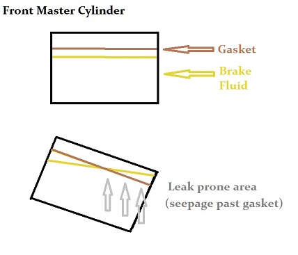

20 May 2011 10:02Marneman wrote: ...angle is just too far off on the LTD model.
Yes. Where sitting off-level allows the fluid level to reach the gasket, there is imo far more risk of leakage, sooner or later.
Consider an unopened Coke bottle sitting in the fridge.
Standing vertical, it won't leak past the cap, even if the cap doesn't 100% seal.
Laid on its side, the potential exists for leakage past the cap.
