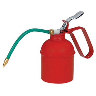

get a pump up oil can and attach a foot or so of vacuum hose to the nozzle(clamp it to the nozzle so you don't push it off when you start pumping).fill it with brake fluid.then pull the brake lever in and tape it closed to the handlebar.then attach your hose to one bleeder and open the bleeder on the other side.you should be able to pump fluid from one side to the other,forcing the air out.once it runs clean lock them both and release the lever.now re-connect your hose from the oil can to one of the bleeders and with the lever open (you may have to pull it in slightly to allow the fluid to flow up,i haven't done this in awhile and am going from memory)pump fluid up into the reservoir until the bubbles stop and then go ahead and push up enough fluid to fill it up.

Thanx leon, i will have to try that, although im not sure what a pump up oil can is.

asevens,a squirt type oil can(that you fill with oil or whatever) that you use to squirt oil on stuff.
