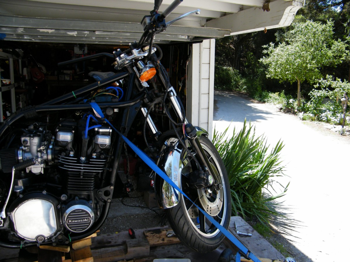

02 May 2011 16:28martin_csr wrote: ...the right side I drilled the hole darn close to where it needed to be, probably within 0.5-1.0 mm but not quite far enough from the bar's end, so the throttle grip has an audible vibration when I take my hand off.... kind of annoying. I guess the incorrect hole location is why it's vibrating....
Handsome bike!
Throttle grip tube should not vibrate against the handlebar when not being held onto, even without the rubber grip.
If the rubber grip is serving as a vibration damper by rubbing against the end of the handlebar, the rubber grip is pushed too far onto the handlebar, as this particular vibration damping activity isn't a purpose of the rubber hand grip, imo.
Besides the minimal resistance inside the throttle cables as they move back and forth, there should be basically no resistance to "spin" of the throttle tube around the handlebar, within the limits of its designed movement arc.
Some folks apply grease between the handlebar and the throttle tube, which might incidentally help quell some vibration, but is imo ill-advised.
Would suspect some other cause of excessive throttle grip vibration besides the location hole being 0.5-1.0 mm too close to end of the handlebar.
Consider, sometimes it's necessary to move the throttle fitting even further out on the handlebar to afford slight additional space for master cylinder clearance, in which case the end of the tube extends slightly beyond the end of the handlebar.
Just my 2ยข.
- Posts: 7993
- Thanks: 1648
Re: Handlebar holes pins
02 May 2011 19:20 - 13 Feb 2013 13:20
Well, there's no other reason that I could find for it to be vibrating.
After all, gee, how complicated could it be to reinstall a control housing & throttle grip.
