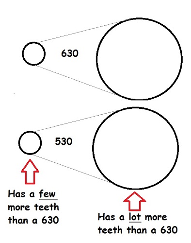

With a 15 tooth front 530 sprocket you may have a problem with the chain hitting the swing arm pivot. 16/45 or 17/48 would probably work better.
530 is 5/8" pitch (tip of one tooth to tip of next tooth), and 630 is 6/8", or more commonly called 3.4", pitch. So 15 times 3/4" is a lot more than 15 x 5/8".
As to the 530 chain being strong enough for a GS1150, 530 is the stock size for the ZX11, ZX12, and ZX14, and I think Hayabusa also.
I'm not familiar with the GS1150 motor, but I doubt there's room for a spacer behind the sprocket.

Sounds like you need an 18 tooth front and a 50 tooth rear to maintain the same ratio. The link spacing is shorter on the 530 so the sprockets need more teeth to be the same diameters. Modern 530 chain is every bit as strong as 630, and some will contend that it lasts longer due to the drive load being spread amongst more teeth. I don't know about spacing a sprocket out, you may have to order an offset front sprocket.

Identical size sprockets will produce same ratios irrespective of tooth count, or with a belt drive.
