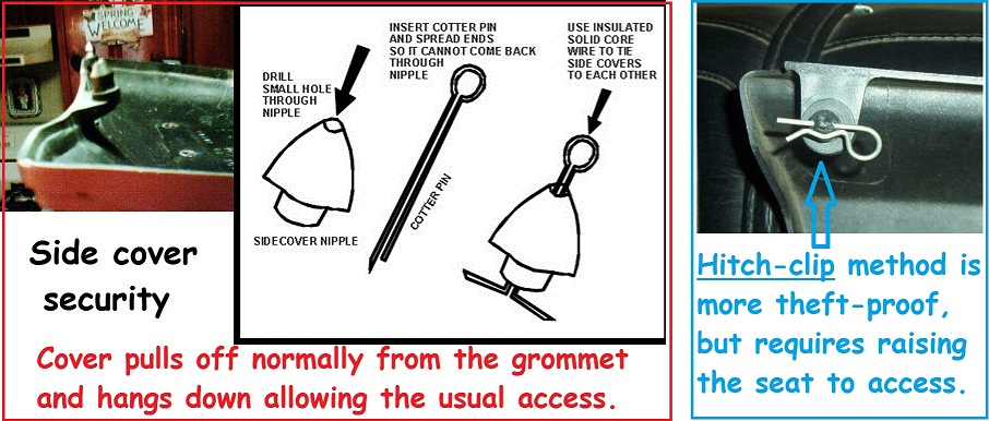

When you do get a replacement cover, do like lot of owners are doing and drill through the plastic studs so a lanyard or a cotter pin can be used to secure the cover(s). A new set of rubber grommets will greatly reduce the chance of them flying off too.
www.z1enterprises.com
sells new grommets.

If running individual pod air filters instead of the stock air box, the side covers reportedly have a greater tendency to blow off the bike.
As martin suggested, if in doubt about age or condition of the grommets, would replace all of them with new grommets from Z1 Enterprizes. In addition to providing additional owner-supplied security as also mentioned.
Click > Grommets from Z1E
