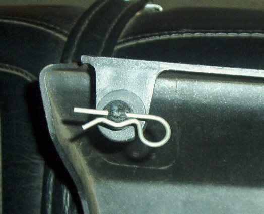

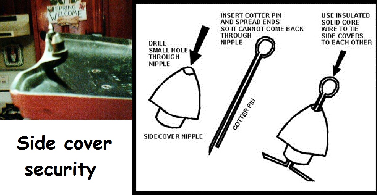

Speaking of grommets. The grommets that hold the side covers on dryrot and you'll (you WILL)lose a side cover down the road. If you don't know, original covers are like gold. Replace those 6 grommets and search this site for some ideas on locking them in, from both falling off and being stolen. I lost one of mine when I first took the bike out of storage but I was lucky enough to be able to sand out the scratches.

21 Apr 2011 22:41Kidkawie wrote: Speaking of grommets. The grommets that hold the side covers on dryrot and you'll (you WILL)lose a side cover down the road. If you don't know, original covers are like gold. Replace those 6 grommets and search this site for some ideas on locking them in, from both falling off and being stolen. I lost one of mine when I first took the bike out of storage but I was lucky enough to be able to sand out the scratches.
anything that is original to the bike is worth money so don't throw anything out, even hardware. Put it in a box and stash it.
drill and pin them on

If you keep the stock airbox rather than adding "pods", the new grommets are sufficient. They are plenty tight.

the problem with pinning the covers on like that rather than the piece of safety chain around frame tube is if something were to ever start smoking behind there youll have to get the seat open and reach down thru there to get it off

a lanyard like on hood pis can hep with that and are easily found in industrial hardware stores. (not home depot the ones contractors use like McFadden Dale)
