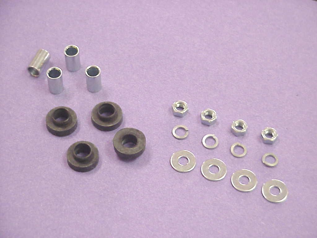

15 Apr 2011 00:49ace wrote: like to know how to secure my gauges.there has always been play since i got her (78kz1000). both move front to back with the bumpy roads.they work just fine but the play is annoying.
If I think what your thinking, The guages themselves are loose on the aluminum bracket!
If so, take the tach and speedo off with the 2 8mm nuts, and cut down the 2 metal collars about an 1/8" or more. Then collars between the rubber grommets.
And put new rubber foam, insulation on the base. This will tighten up the guages and keep the vibration dampener effect going so bulbs don't blow out!
I have done this for years.

For reference:
And might consider sacrificing a computer mouse pad to replace the rubber foam.
