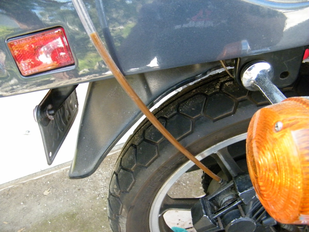

with out pressing the brake ...maybe take a tube and slip it onto the bleeder nipple and just crack the nipple...normally this allows air to get in but i have a feeling that you have pressure somehow..it imo will shoot a bit into the tube...quick close the wrench and see where the pressure is..peddle...rod/plunger...threaded in too much...try wiggling or turning it out a few turns...
note the fluid in the tube is many years old...i just showed this pic to show how a long clear tube can be routed to run a lot of new fluid into the system without a drip can...

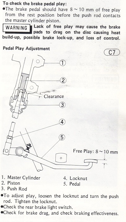

The cure may be a simple brake pushrod gap adjustment to allow proper "cold" clearance.
See image below (from FSM).
The push rod #3 is threaded, whereby it may be adjusted to allow required adequate clearance (gap) between it and the piston while the brake isn't being applied.
After adjustment, tighten the locknut #4 to maintain the correct pushrod gap.
With zero gap, the brake may function seemingly okay a time or two until the fluid heats up and causes the brake to drag. Results in constant friction of pads on disc, with resultant heat, same as if "riding" the brake, until the brake locks up.
When this happens on the road, may release some fluid -- be careful as the disc is very hot -- which should free the brake.
Allow it to cool before completing final adjustment to the push rod gap.
