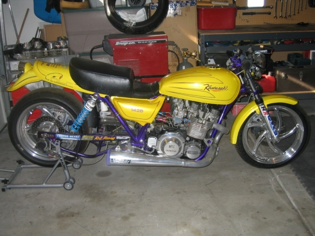

Hey guys,
need some advice. I bought a 6" over swing arm of ebay last year and put it on ran it all last summer. I ran into a problem when I went to take the misses for a cruise,I couldn't due to the fact of my shocks bottoming out(shes only 110 btw) I switch to struts and she didn't like the it,so bought another pair of shocks,and the same thing,bottoming out. So I put the stock one back on,with the new shocks and it completely changed. The ride was much stiffer. I measured the lower mountig points between the 2 and the 6" swing arms are,of course 6" farther back. Does this change the way the shocks react or dampen and how can I run it with out it bottoming out?
For reference,the mounting points are on the side of the swing arm and not the top like most I have seen. It looks like an ameture built it. Any help would be great. Thanks.
Heres a pick of it with struts.

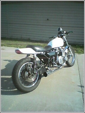

yes racer54 that is what I am experincing! The current shocks are 13.5",which is stock on the stock swing arm. When I had the other one on there it was real soft. I do have a set of 11.5" shocks that I had to lower it before I got the longer swing arm. Could I move the mounting point up on it and use those or would that affect the geometry of the suspension? I am like you LEARNING!
Here is a pic with the 11.5 shocks. Rode real good.
I belive this is a members bike. The idea I am goin for.

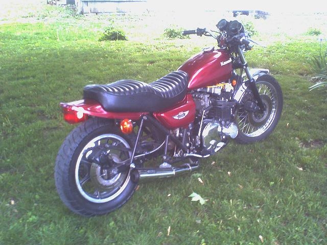

Here is acouple more of members bikes with shocks. The white one looks like the shocks are mounted where the turn signal mounts. Is that safe and enough of support for them? Thanks again for input.
Mike
Mike
