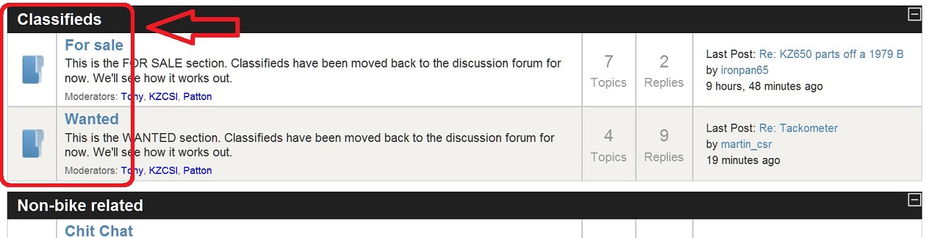

Am I blind or overlooking something? Since the website redesign, I can't find the classifieds.

Under forum categories:
