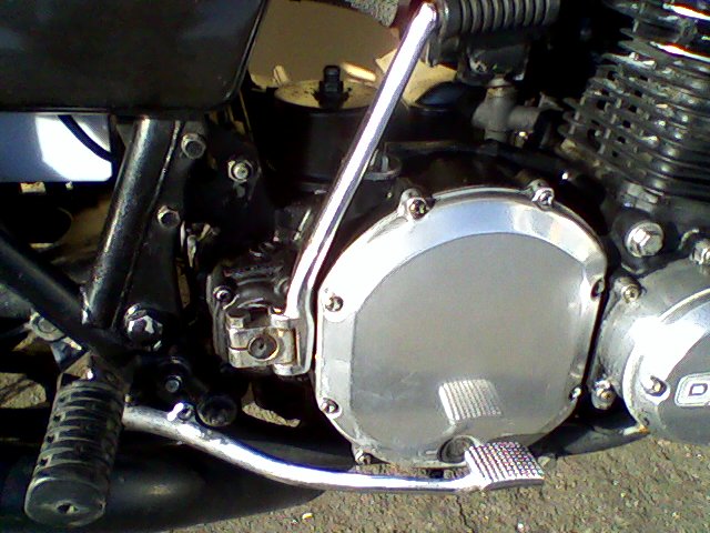

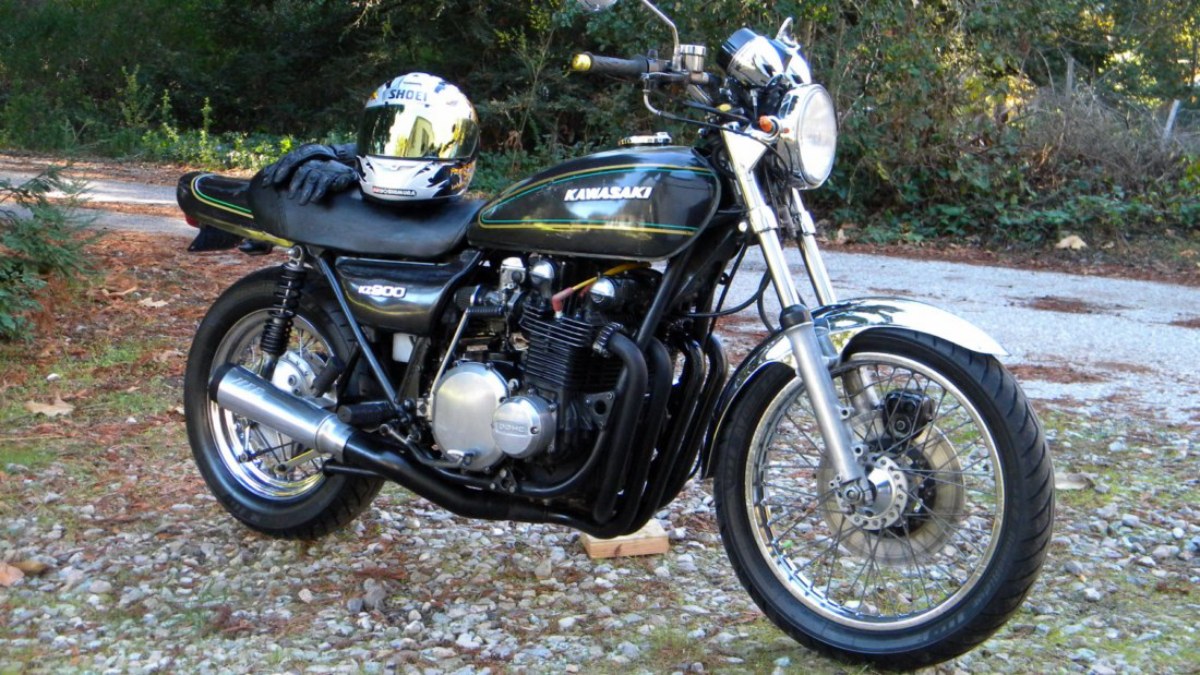

this picture shows a set of rear set pegs using nothing more than what i began with...if you look close you can see how the pegs are now up and back almost right where the rear end is pivoting on the swing arm bolt...these are comfortable and do not chew my shoes up...they are tucked in tight and do not scream hack job...my feet are big enough to reach the controls with my tippy toes and some scrunching up for shifts...i will shorten the brake and shifter one day...
sorry the pic is not a close up it's raining cats and dogs now or i would get a better shot for you...

here is a closer phone pic of the peg bracket swapped from the other side...flipped upside down,and the peg pin pulled..pegged flipped right side up and pin put back...big up and back difference with little cosmetic change

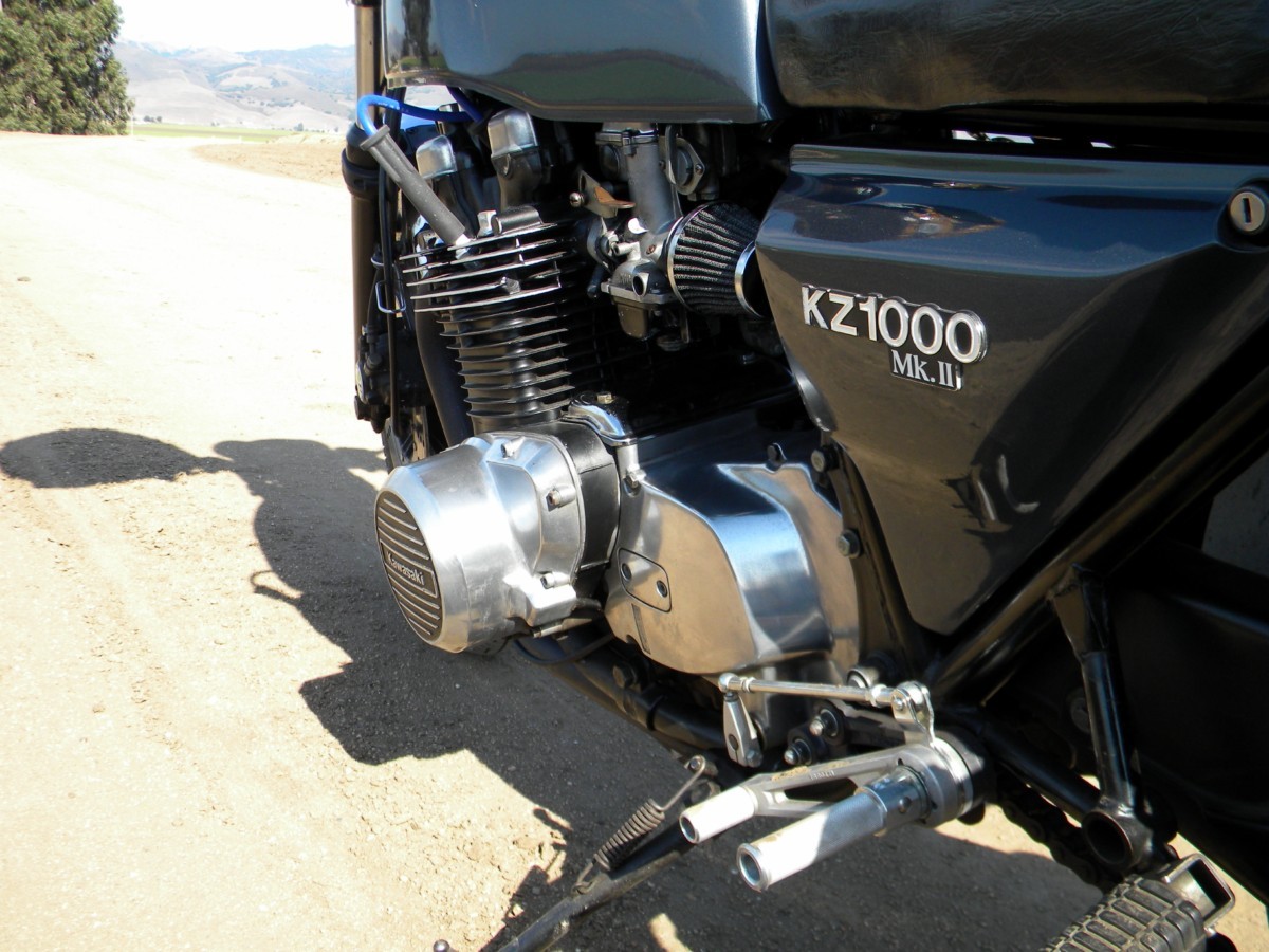

Raask rearsets
remove foot pegs and install.

now those are nice!

Fast From The Past still sells the tarozzi kits. At least their website still lists them.
trianglelaguna, any pics of the shifter side? I ran out and flipped my pegs over yesterday after seeing your picture, but my shifter is waaay too far away. What did you do, if anything?

jimstan wrote: Raask rearsets
How do you shine your engine case? That's beautiful!
