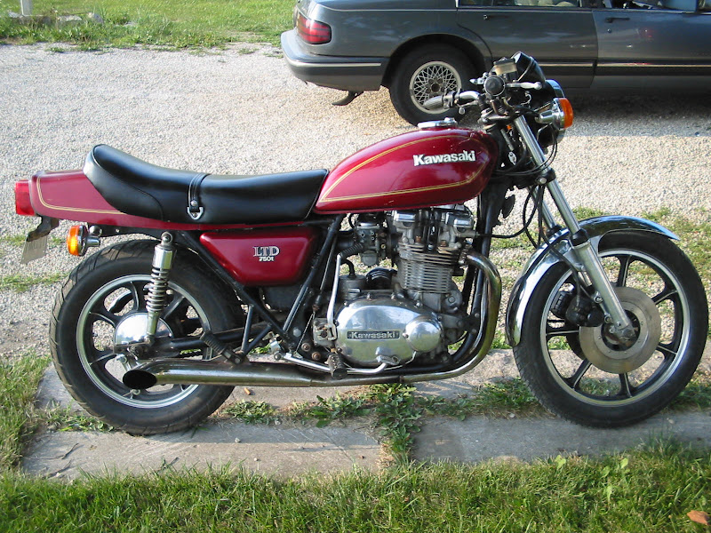

I'm the one with the 750G frames(s) that contacted you.
I originally assembled everything on a 750G frame, but when I had problems with the title I transferred everything to a 79 750B frame. I even used the 750G swing arm on the 79 so I could use the G mag wheels. But then I bought the Morris Mag wheel kit and swapped the 79 swing arm back on again.
The only original 79 parts on my bike are the frame and wiring harness :laugh:
Here it is as an 80 750G
And as a 79 750B4 (frame and wiring harness is anyway)

Ah so the G is an 80 twin. Cake walk for him then. Nice bike, btw.
