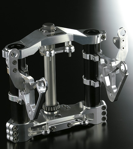

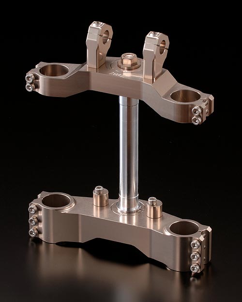

when converting to late model usd front ends they are usually shorter which slams(lowers) your bike.so to raise it back up you need longer chrome tubes or a gullwing upper tripple clamp to give back the lost ride height.here are some nice ones.

www.bulldock-mc.com/
pure japanese motorcycle pornography,enjoy.
the trees are under the mccoy tab on the left.

mark i know you had to notice the gullwing upper,right?
wap,wap,wap!nice,kinda like this bike from bulldock.
check out these smokin hot z1r fairing/headlight/gauge mounts.yum,yum.
