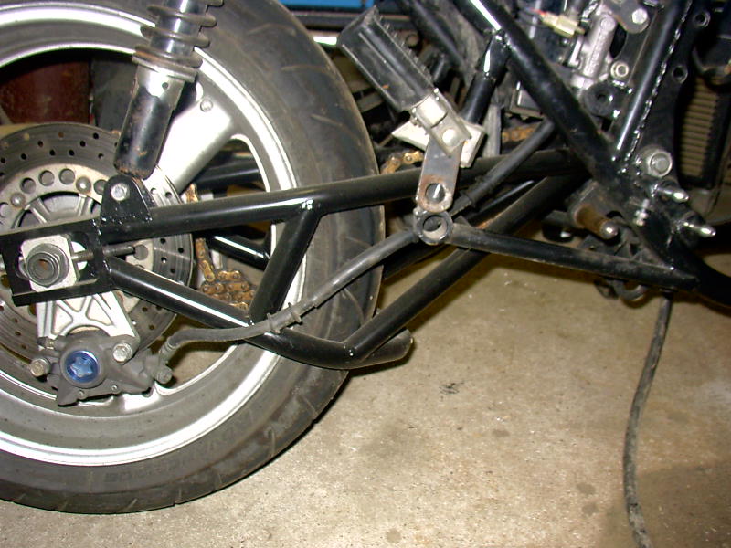

My son has a 95 zx6r. On the caliper of his bike it has a peice that fits into a slot on the swingarm. No "torque arm".

How heavy is your bike? How much is the maximum potential tourque energy that can be applied to a bracket piece with all of that tourque potential moved into a very small angular velocity at the very end of the swingarm? - not its intended design, for sure?
Can it be done? Absolutely! ...but only with the correct level of engenering science applied.

i used the brembo brake and the bracket from an r1 in my custom built swingarm and it does not have a torque arm.the bracket has a rectangle boss that slides in a slot thus negating the need for the torque arm.not the best pic but you get the idea.
