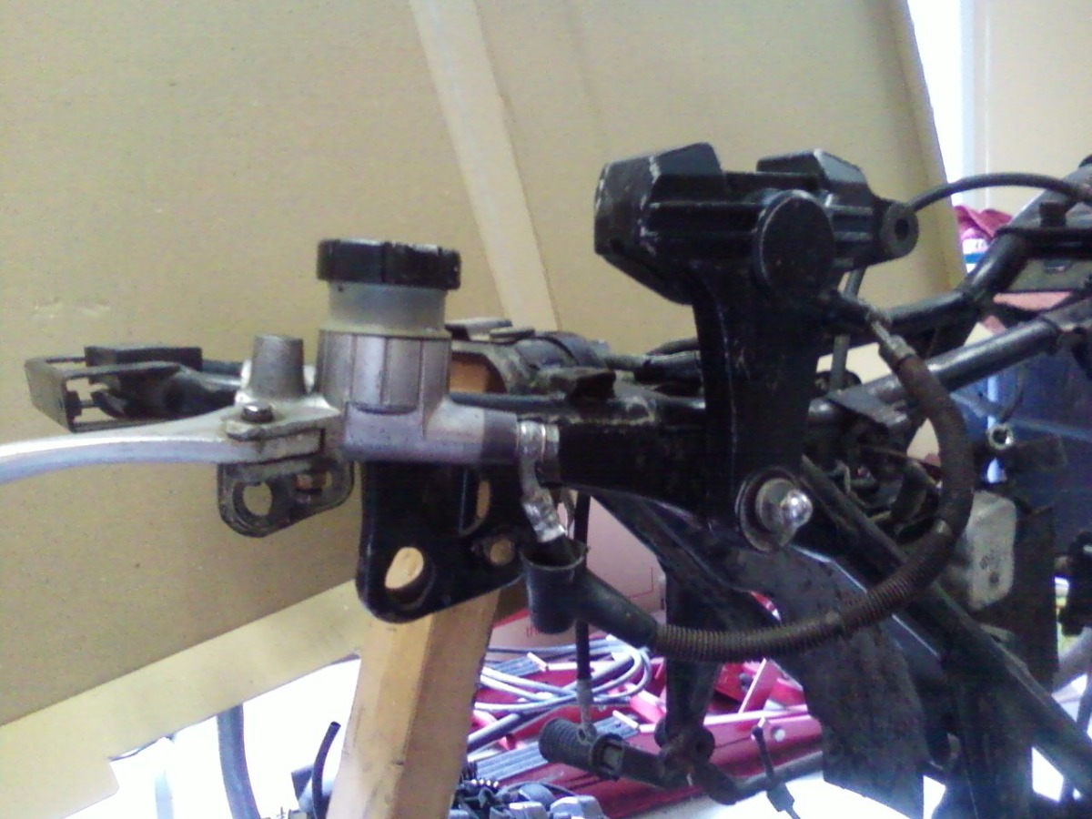

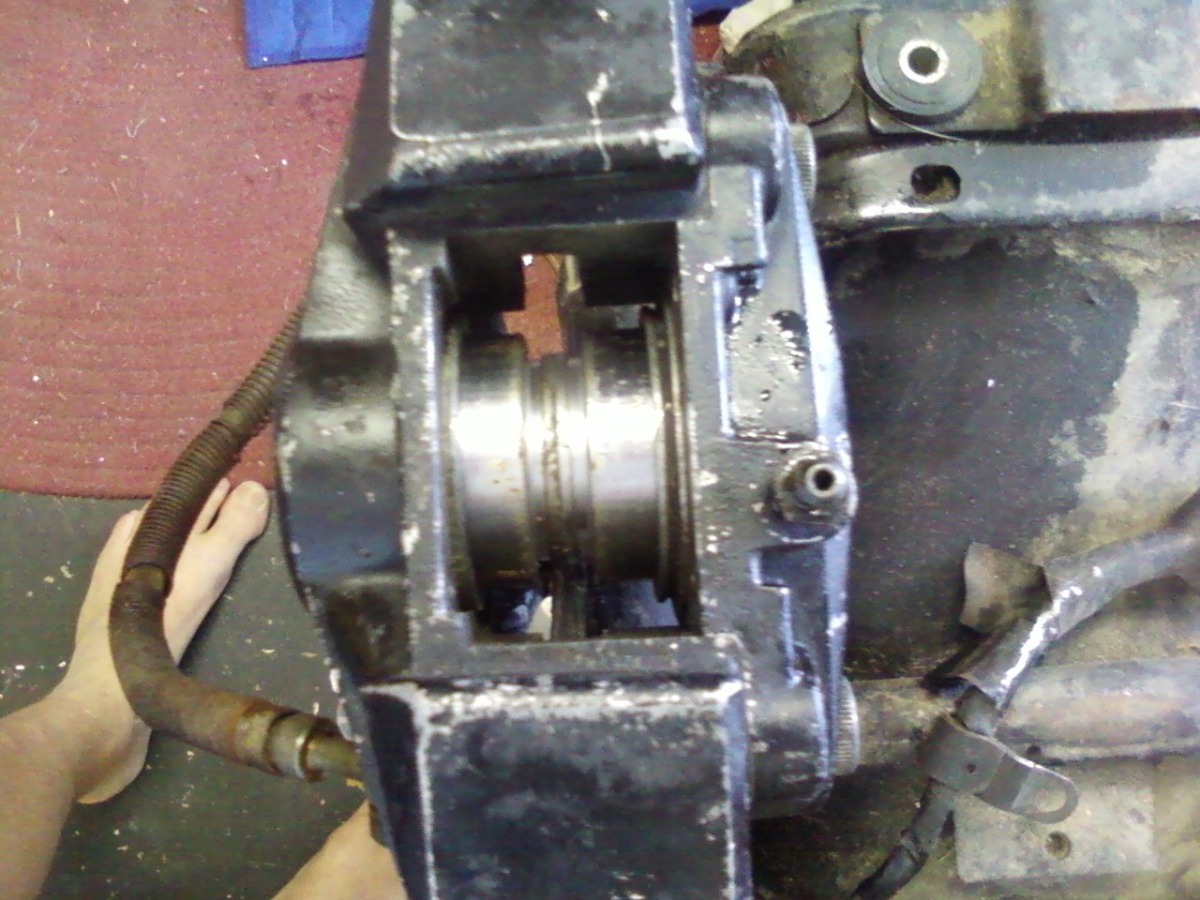

Old thread but what the hell, even older pictures
I was able to force the pistons out by relocating the front brake master cylinder and back brake to the frame and pumped the pistons out with dot 3
