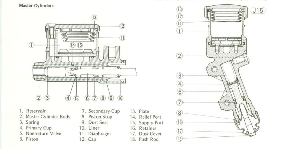

- bluej58
- Posts: 2474
- Thanks: 507
Re: Broken-Hearted over '78 kz1000 rear brake!
12 May 2013 11:05 - 12 May 2013 11:07
Here is a diagram from the Kawasaki shop manual for the 78 A2A but it should be similar to yours.
I would soak it in Dot3 to try and soften up the dry fluid , wear gloves and keep it away from anything painted.
After a few days try again to remove the parts.
Once the parts are out clean the master cylinder with rubbing alcohol "real good" and repaint with VHT caliper paint and bake in an oven as per instructions.
My wife loved that part
Good luck
