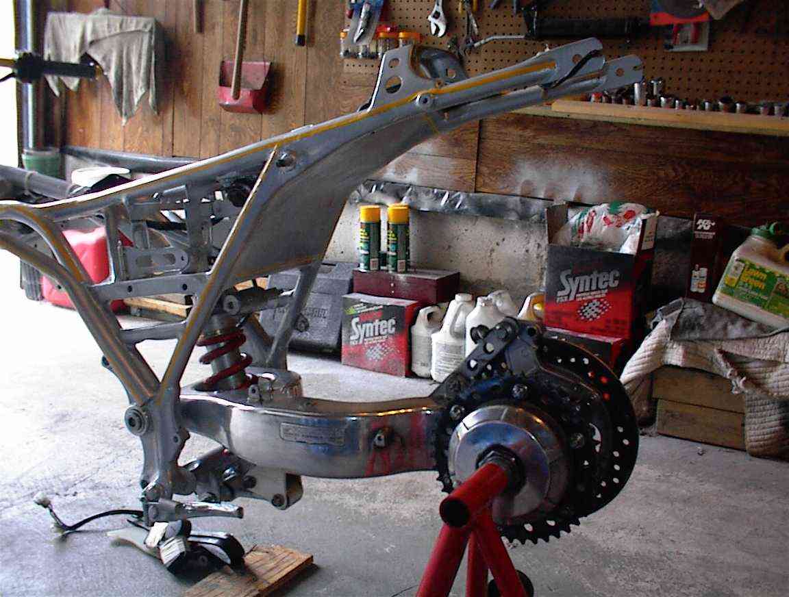

Ducati SSSA (or their convetional swingarms for that matter) have a goofy set of linkages compared most other mono-shock setups.
Ducati 848 rear suspension linkage...
Compare that to a VFR linkage...
And the linkage is a little easier to work out. This is why you'll see VFR arm in more bikes that a Ducati arm.
It can be done, a member who used to be on here, Squatch, started a VFR conversion on his Z1. He has yet to finish the bike but photos can be seen here .
Later, Doug
