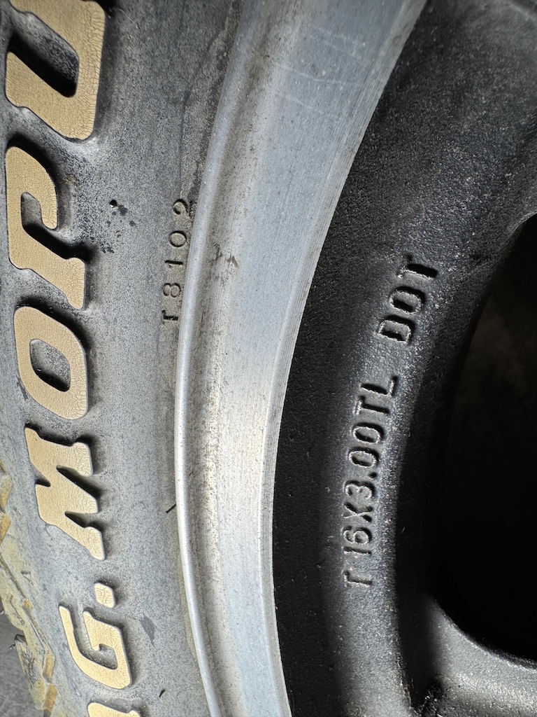

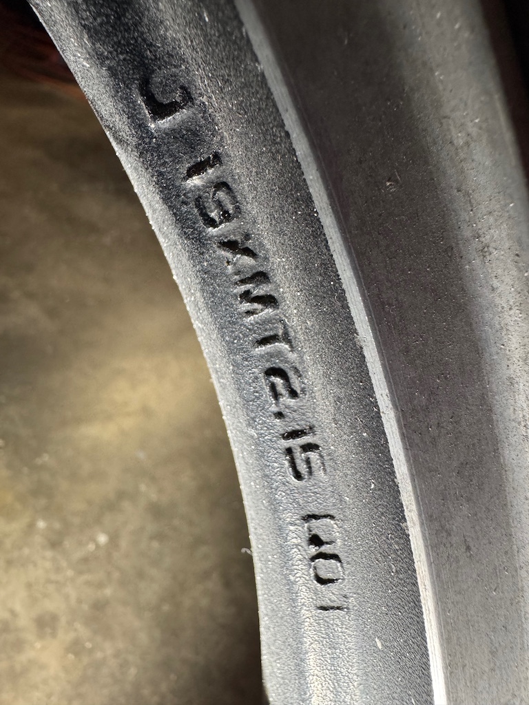

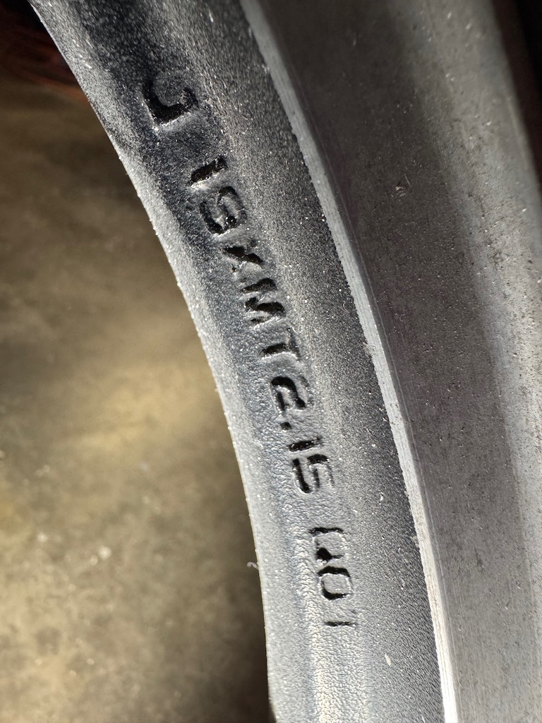

This is an older thread, but I'm starting to replace my tires on a 1980 LTD 1000 B4. It looks like the rear wheel is stamped TL but I'm not seeing the same on the front. It also "appears" the rear valve stem is the tubeless type as the base is all rubber and pretty wide. But the front looks to be on a tube, although the front does not have a lock nut to hold the tube in place. and could be a tubeless. Won't know until I take it apart.
I don't think this bike could have swapped rims as it's been in my possession since 1987.
So could there be tubeless rear and tubed front?

03 Jul 2026 10:19 - 03 Jul 2026 10:20According to the OEM parts diagrams, your bike came with tubes front and rear.This is an older thread, but I'm starting to replace my tires on a 1980 LTD 1000 B4. It looks like the rear wheel is stamped TL but I'm not seeing the same on the front. It also "appears" the rear valve stem is the tubeless type as the base is all rubber and pretty wide. But the front looks to be on a tube, although the front does not have a lock nut to hold the tube in place. and could be a tubeless. Won't know until I take it apart.

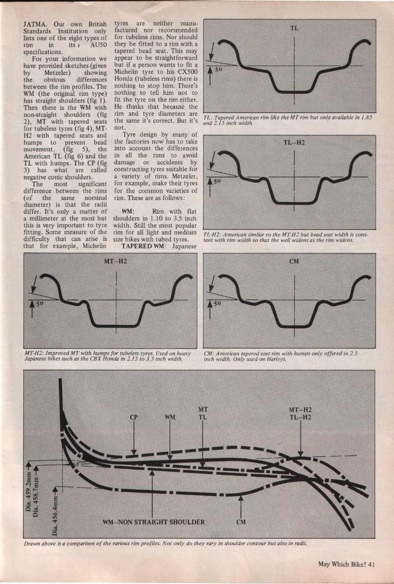

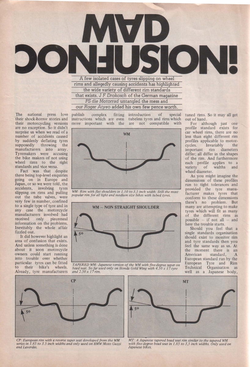

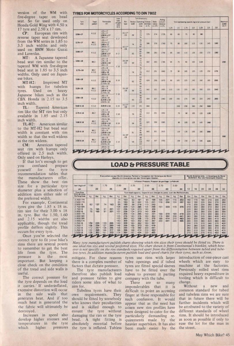

]For those interested in wheel/rim shape and tube or tubeless here is a mag article from 1980 on the subject

04 Jul 2026 04:02 - 04 Jul 2026 04:03Thanks for that!]For those interested in wheel/rim shape and tube or tubeless here is a mag article from 1980 on the subject
We've never understood why the well in rims isn't made just a tiny bit deeper. Especially on cast wheels. Seems it would make tire mounting so much easier.
