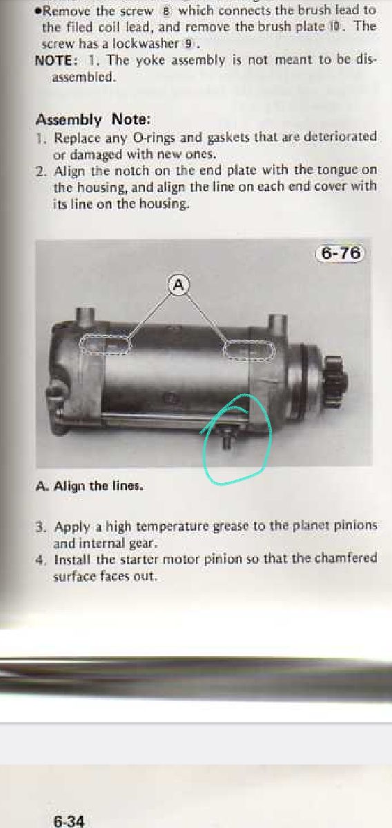

You could do a voltage drop test.
Grab your meter
Meter on DC V
Turn off the fuel
bike shouldn't run... this is so you can test your starter
red probe on positive battery post
black probe on the starter lug(lug is in the green circle below) that the positive cable attaches to.
press the starter button
what is your voltage?
move red probe to negative battery post
black probe on engine block
press starter button
voltage should be as close to a steady 0.0v as possible.
