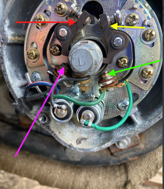

Thanks for every one's suggestion. My adventures in starting the bike today consisted of checking the voltage at the coils with ignition on and while cracking. with just the ignition on I was seeing 10 + volts the battery is showing over 12 v but as a buffer I hooked up a jump pack to make sure I had enough voltage. During the cranking process volts would drop around 3 to 4 volts this is on each coil. Manually opening and closing the points did not produce spark and they did have voltage around 11 volts. Also I did burn my finger on one of the points I know resistance produces heat so there is resistance at the points based off of my finger heat meter. my thoughts now is maybe it is the points I did make sure that when I replaced the condenser, I put the isolators back in the same position as I took pictures, I always take pictures. Attached is a picture of the old and new condensers wired up

10+ volts at he coils with the ignition isn't enough. Trace the wires and clean the contacts

- F64
- 81-KZ440D2
- Posts: 1233
- Thanks: 450
Re: 1979 KZ 650 sr no start no spark
12 Sep 2026 19:53 - 13 Sep 2026 09:18
Grab your volt meter
set the meter to DC V
turn the key ignition on
kill switch set to "RUN"
bike not running
put your red probe on battery negative terminal (metal part of battery)
black probe on the nut marked by the pink arrow while pushing the points apart(marked by red arrow).
what is your reading?
close to 0.0V or close to 10V?
move your black probe to the green arrow nut and press the points apart( marked by yellow arrow)
is the black wire from one of the condensors touching the rotor?
turn off bike
bike not running
turn off bike
