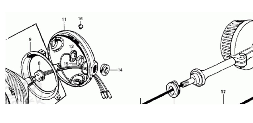

17 Aug 2026 07:24 - 17 Aug 2026 07:291976 kz900-A1 front forks diagram >> www.partzilla.com/catalog/kawasaki/motor.../kz900-a4/front-fork
Last edit: 17 Aug 2026 07:29 by H1Vindicator.

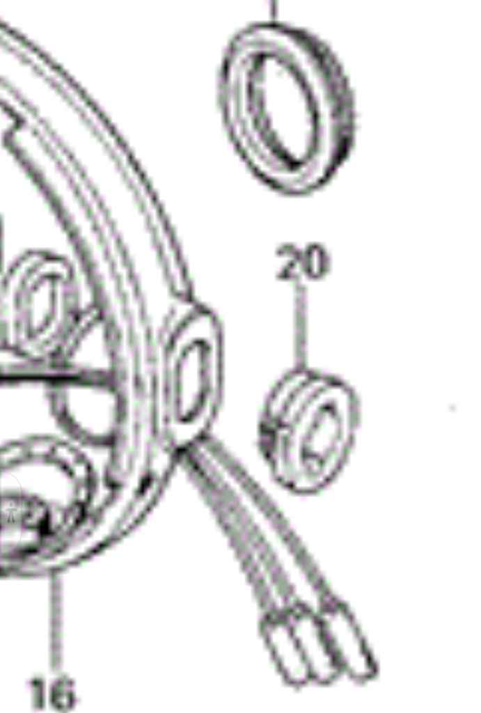

Part 20, should fit into the hole in the headlight bucket then the circular part of it will locate snuggly into the indicator foot plate. Once the nut is tightened inside the headlight bowl the indicators will sit flush.
You have them on backwards with the circular part butting the headlight bowl instead of the indicator.
i.e. take the grommet off the indicator stem and insert it into the headlight bowl first with the circular end on the outside.
