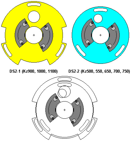

I have a 1977 KZ650 that’s a bugger to start when cold, once warm starts straight away no problem.
have been advised to fit electronic ignition but the problem I have is that my points mounting plate measures 65mm diameter but both types of stator plate that I have seen for DYNA & Boyer Bransden electronic ignition measure 95mm diameter
