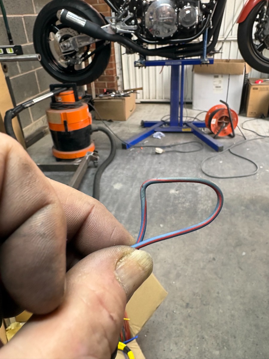

Whilst working on my build at the weekend I came across a classic example of something mentioned in my "fault finding guide". When it comes to tracing broken wires it is often possible to pin-point as the wire bends in an unnatural way - that is to say that when you bend it rather than following a uniform radius the wire actually "folds" at the point where the core has failed. You can see this in the below pic where on the left the break is !! In this case the cable actually feels "limp" at the broken point.

Is this a "single core" cable, or an original-Kawa- multi-copper-wire"-cable?
However, a case like the one you’ve shown here tends to occur more often with single-core, "stiff" cables—those with a solid core.
Such internal breaks are relatively rare in multi-strand cables, which are significantly more flexible and can withstand more bending....Right?

06 Jul 2026 10:41 - 06 Jul 2026 10:42This is the OEM oil pressure switch wire (single core is almost never used in automotive applications) this is often the result of compromised insulation allowing moisture to penetrate and rot the core. I had the same thing with an ABS sensor wire on my 5 year old Jaguar !!!!Is this a "single core" cable, or an original-Kawa- multi-copper-wire"-cable?

I’m familiar with this kind of wiring issue—especially on our Kawasakis—particularly where there are multiple soldered connections (like at the main junction box behind the colored connectors). Over time, the solder joints can corrode, leading to sudden increases in electrical resistance and heat buildup.
However, the kind of example Wookie58 showed could also a result from someone having pierced the wire with a sharp-tipped test probelight, allowing moisture to constantly seep in through the damaged insulation.
