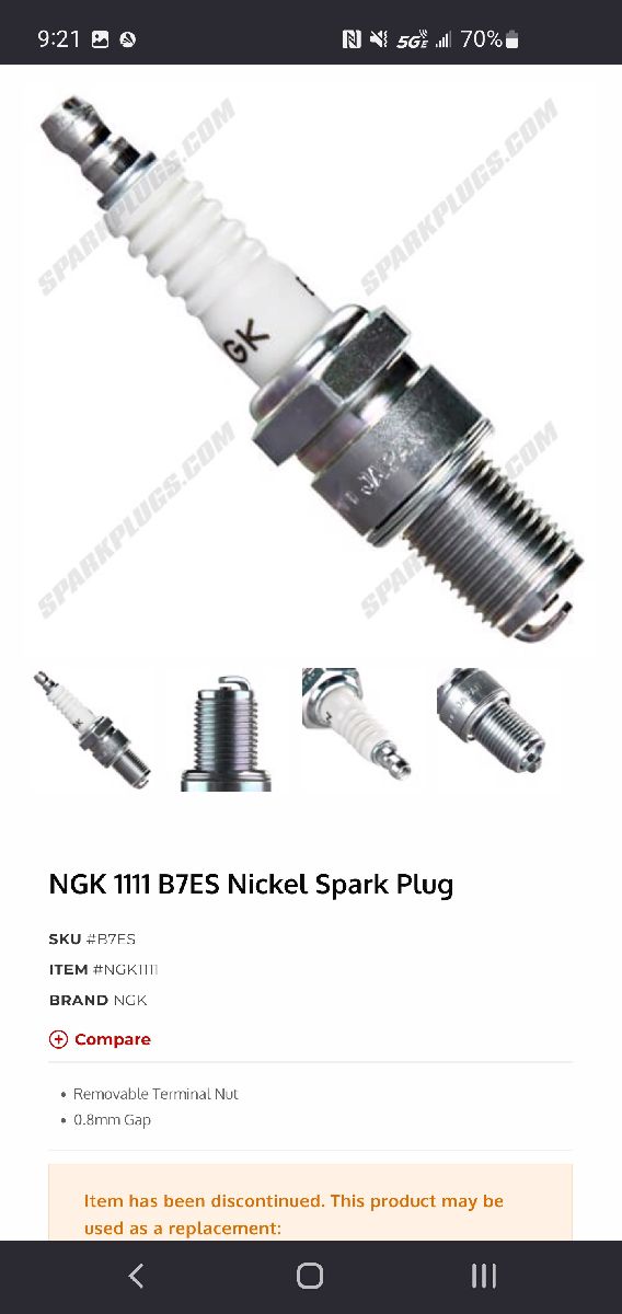

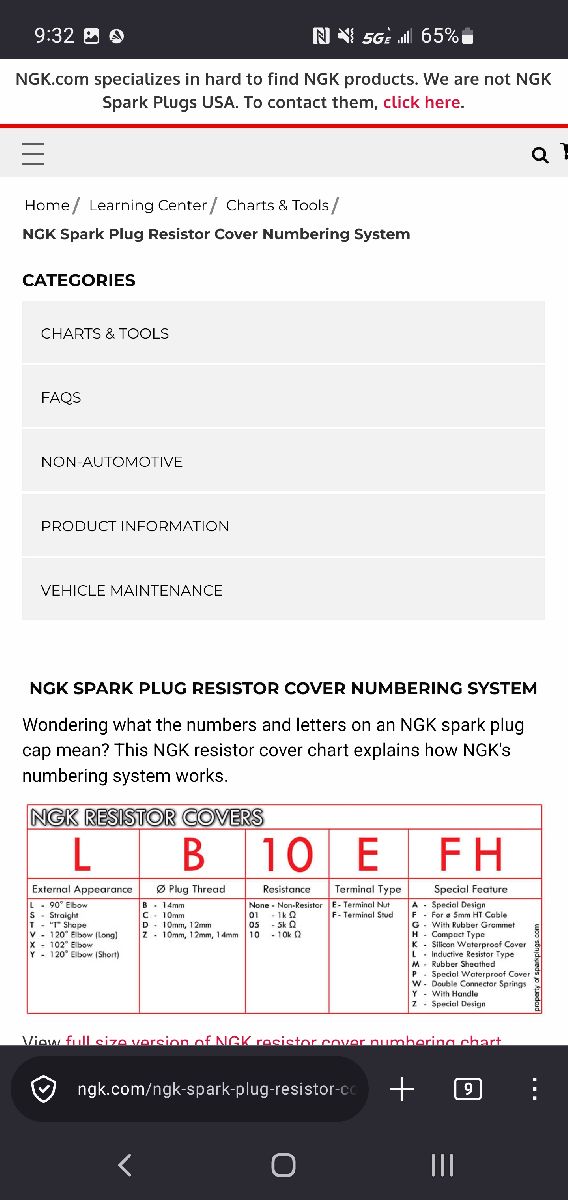

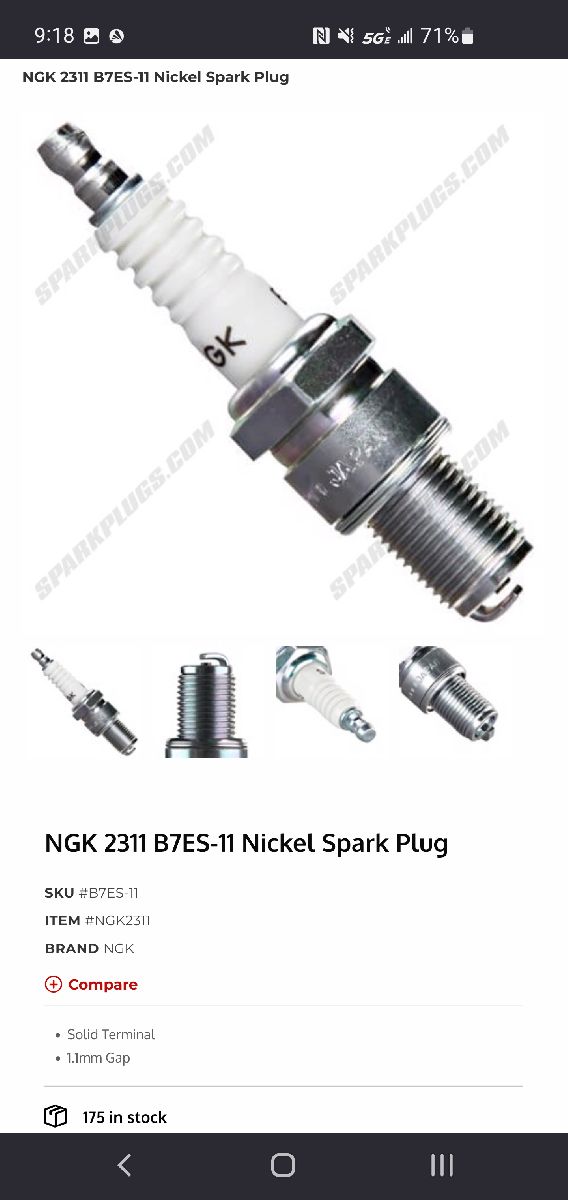

yeah, there different versions of the same plug..
i'll try to dig up the info.
2311 B7ES-11 is a solid terminal plug
1111 B7ES has a removable terminal plug
www.ngk.com/search/all?q=b7es
www.ngk.com/search/partname?q=plug%20cap
assets.sparkplugs.com/lc/NGK_Resistor_Covers.pdf
ok, i'll stop now 🤣
