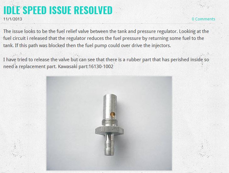

check the fuel tank relief valve is not stuck/sticking it comes apart to clean, remove from tank & just push inner valve out with drill of correct size, quiet often the root cause of running rich.

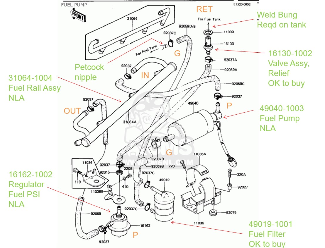

As rangeroy mentioned those gas tank check valves can gum up, I hear some owners just took the check ball out so it can't happen. It is attached to the bottom of the gas tank to return unused fuel to the tank (return line)
