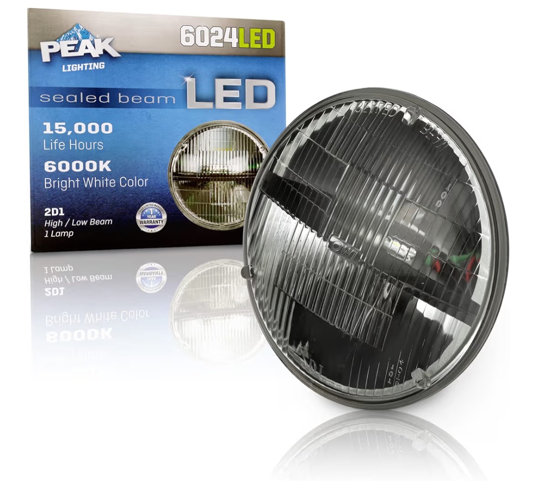

I dont have any good recommendations but I've been looking around also and found that sealed beam LED units are the most likely to have a good pattern and brightness. Its hard to find them that look classic and not like a cyclops. One such headlight I've been considering is one like this:
It meets DOT specs and doesnt bulge out unlike many semi-sealed units. For a good quality unit you are looking at around $100. You might have a harder time finding a 5 3/4 inch unit.
