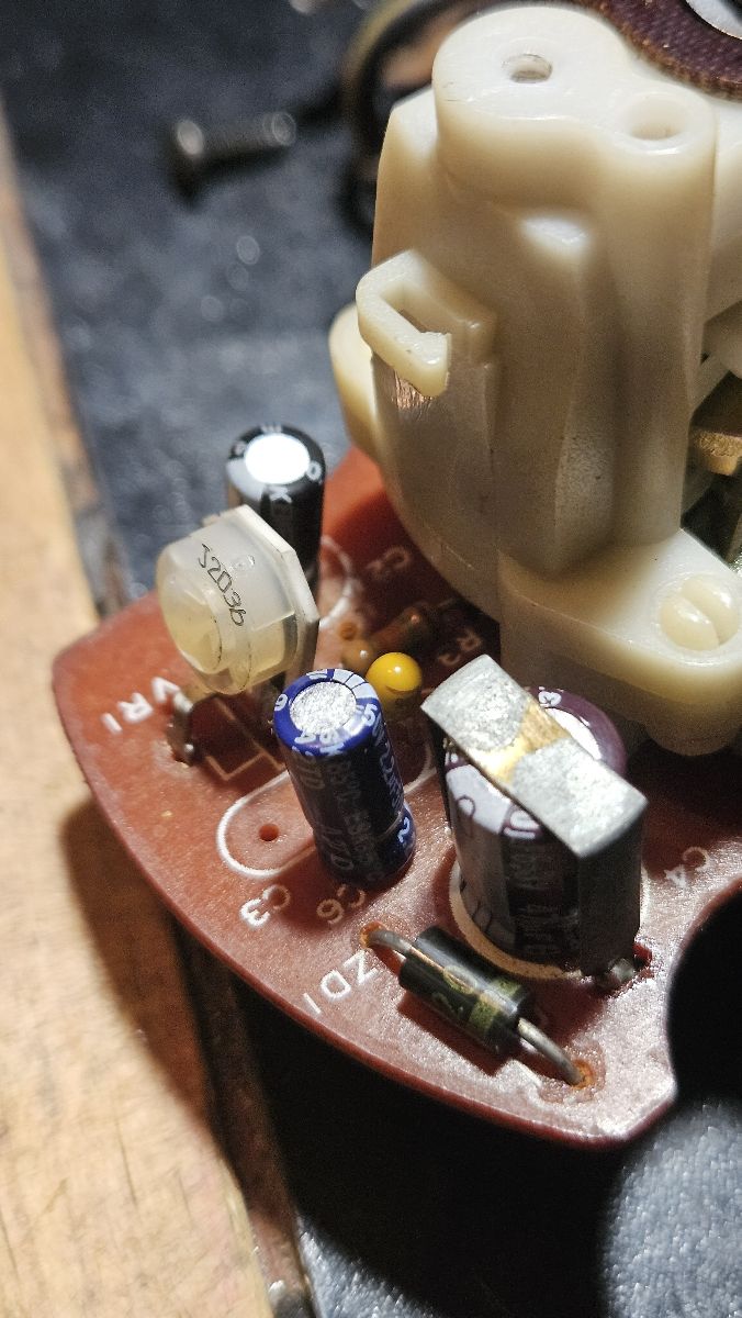

Well i got bored today so I found the capacitor sizes.
C4) L=13mm Dia=10mm 6.3V 470uF +105C
C6) L=11.5mm dia=6.5mm 25V 47uF +105C
C2) L=7.5mm dia=4mm 50V 2.2uF +85C

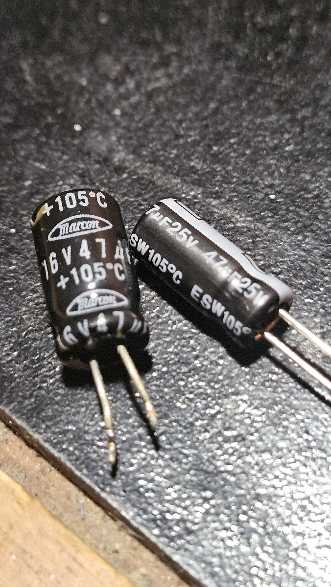

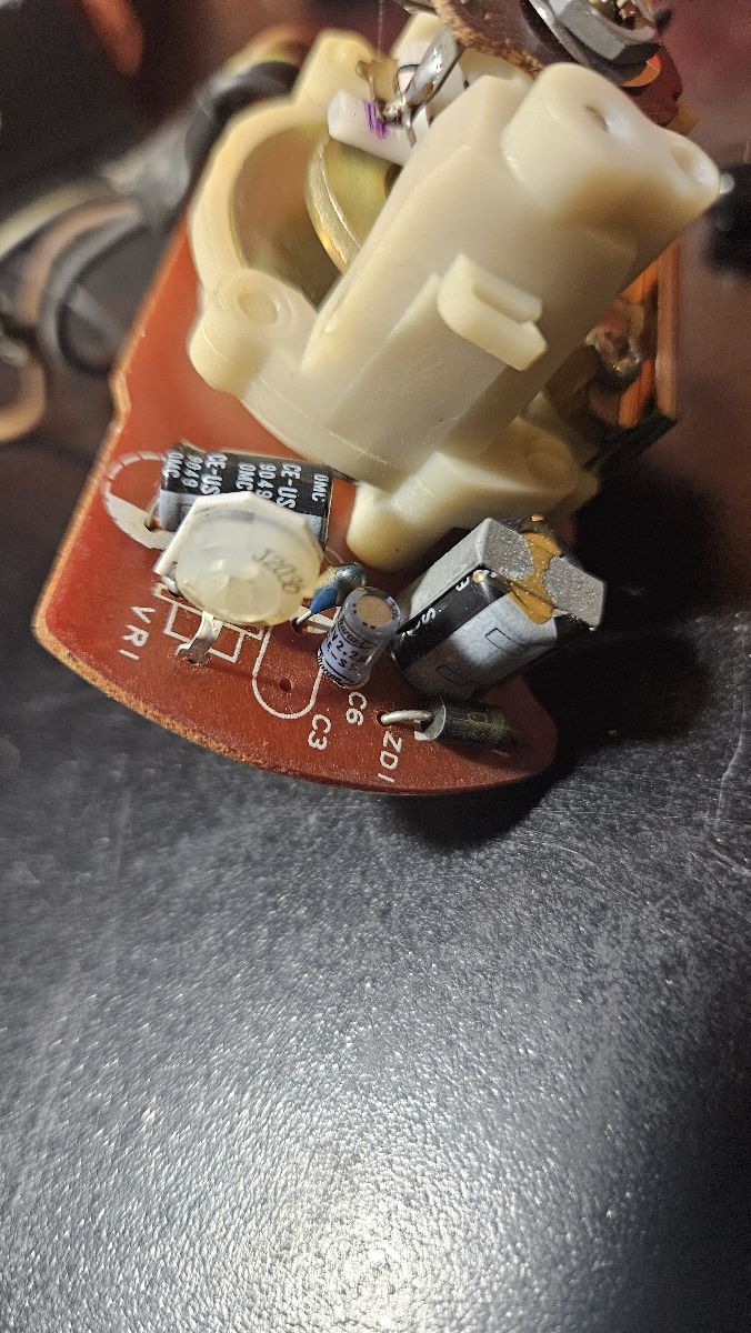

So i finally got the capacitors in the mail today and decided to take a crack at it! in the process of putting the new capacitors in i though that i bought the wrong capacitor 😱 however, it looks like it uses a different capacitor than the other tachometer i pulled the capacitors off of (old one on left and new one on right).
I looked it up and apparently the voltage difference shouldn't affect anything???? Therefore I decided to just go for it and use the 25V capacitor instead of the 16V. I put it all back together now so we'll see how it works! OLD
VS NEW
(FYI there was a .22uF 35V tantalum capacitor that I also replaced but never mentioned)

Very curious about how this works out for you. There’s a potentiometer for adjustment on there. But I don’t recommend adjusting it without some kind of reference. I used a small battery powered oscilloscope to measure the frequency of the ignition coil inputs while I was adjusting mine.
