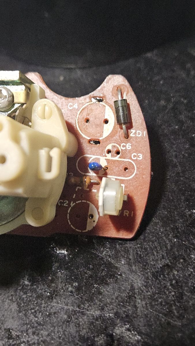

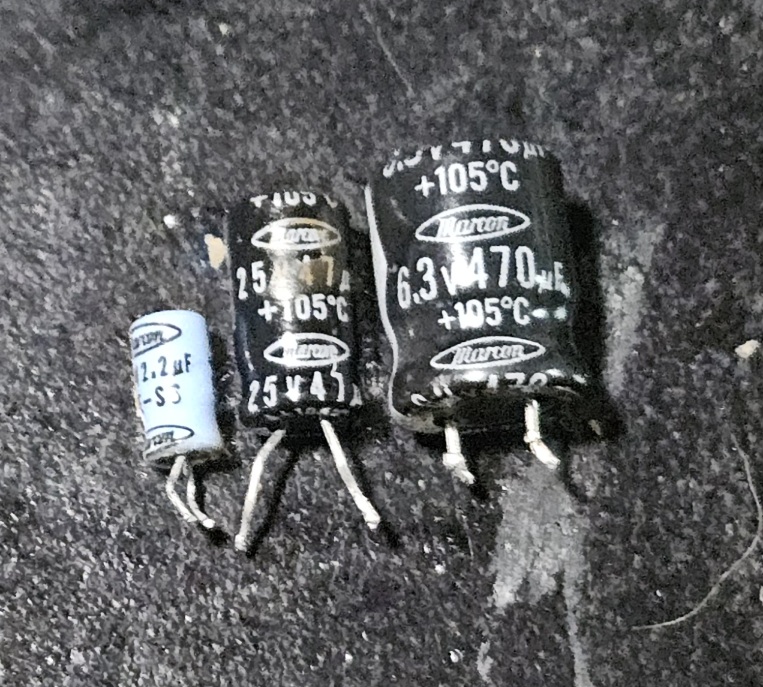

Well i got bored today so I found the capacitor sizes.
C4) L=13mm Dia=10mm 6.3V 470uF +105C
C6) L=11.5mm dia=6.5mm 25V 47uF +105C
C2) L=7.5mm dia=4mm 50V 2.2uF +85C

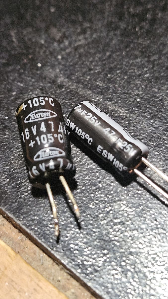

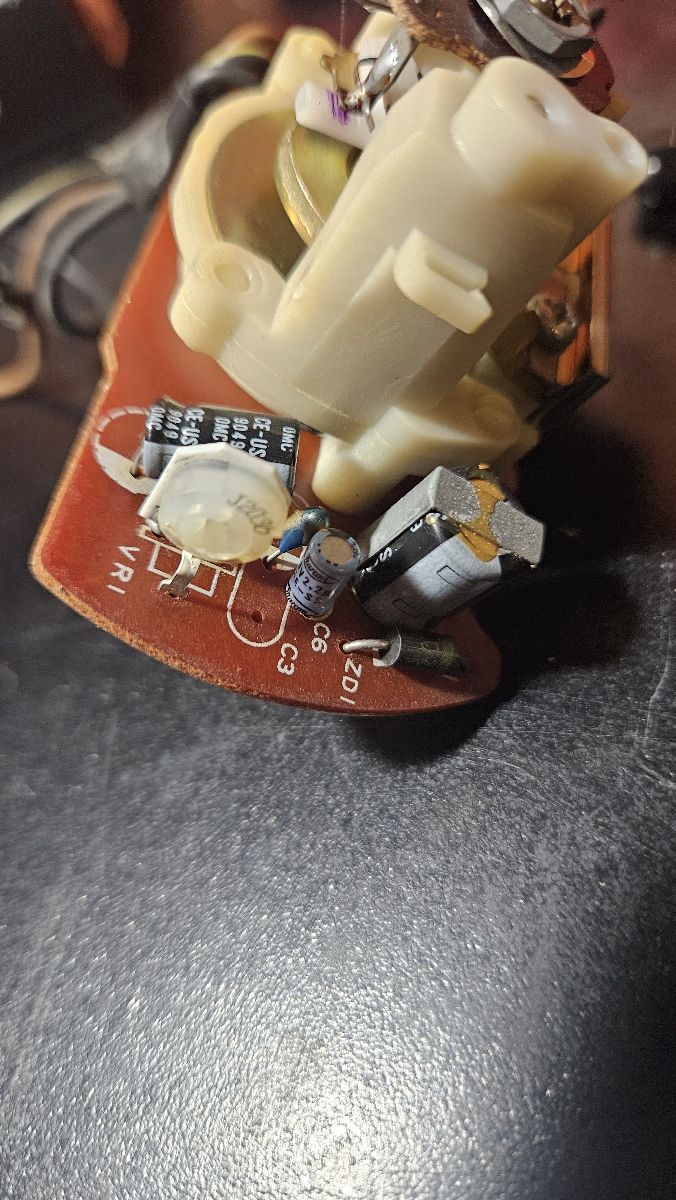

So I replaced the whole instrument cluster and guess what? Yep, that's right. The newer tachometer has a similar problem! I rode my bike tonight and at 55mph i was at 4300 rpm so thought I was in 4th gear but then I sped up and my rpm dropped to 3600rpm!!! There are issues in the 6k rpm range where the gauge needle will fluctuate. Geez I'll never catch a break. Does anyone have recommendations or advice when replacing these capacitors? I know they are polar but is the white part on the circuit boards positive or negative?

As a rule for sane people, circuit boards and electrolytic capacitors are always marked on the negative side.
