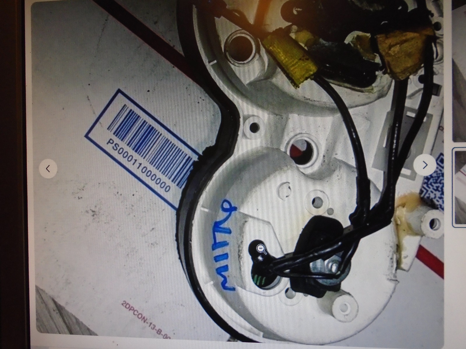

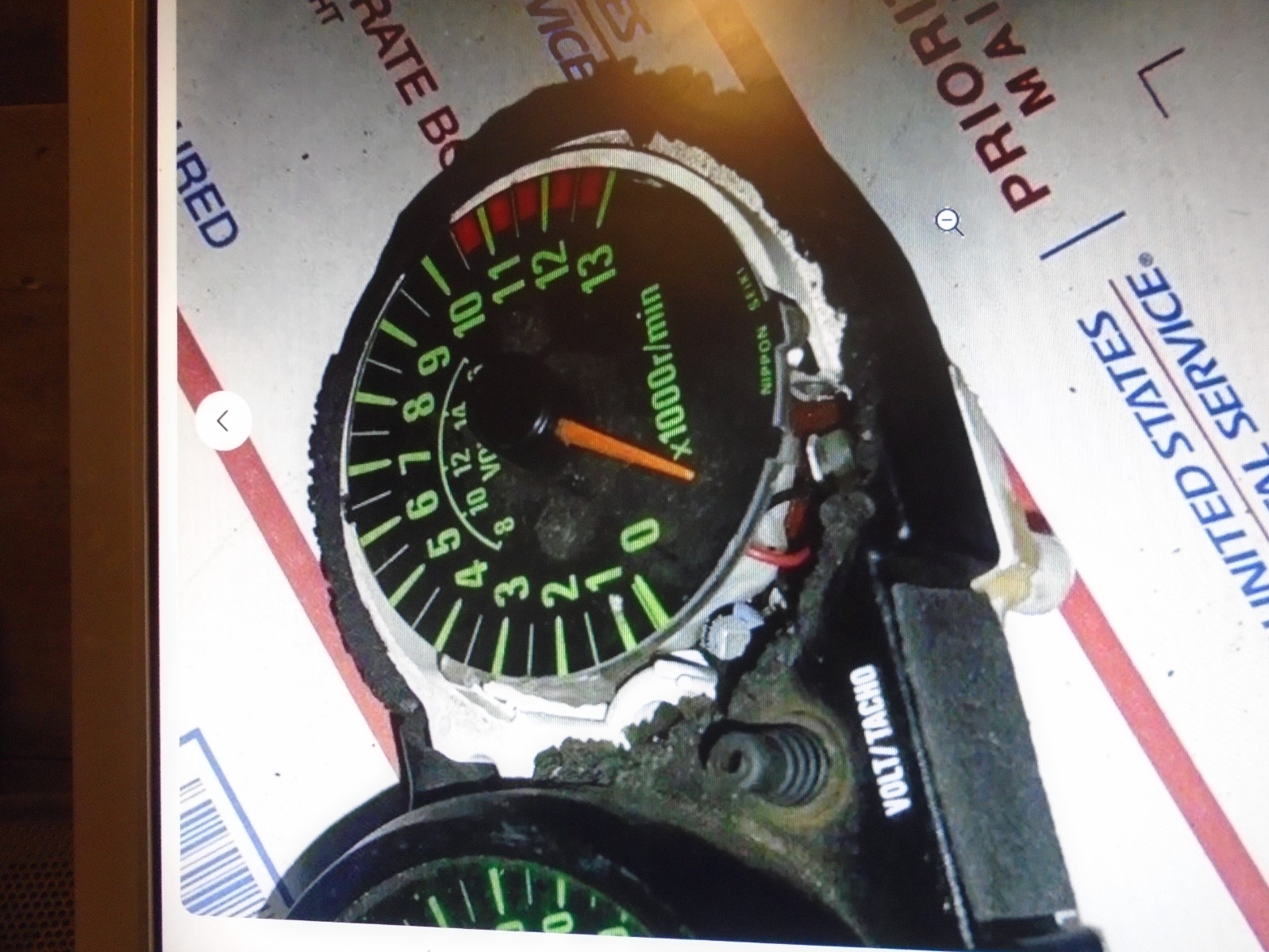

Wish i had more info to share 1015 but i've never had any experience with these. But does seem the shared big black shared cover is thermo-welded to the gauge mechanism/illumination white flat plate. There is, seem a variation of the same, GPZ750. Eventhough a 150MPH speedo, comes apart. It comes apart because the speedo is offered separately. Part number 25005-1218. Here are a couple photos i found on ebay of someone's attempt of
removal, ain't pretty ha.

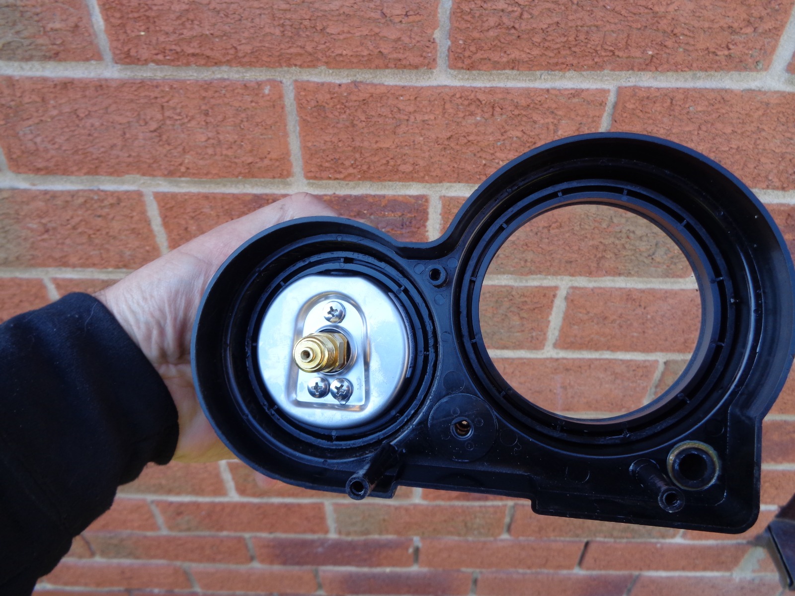

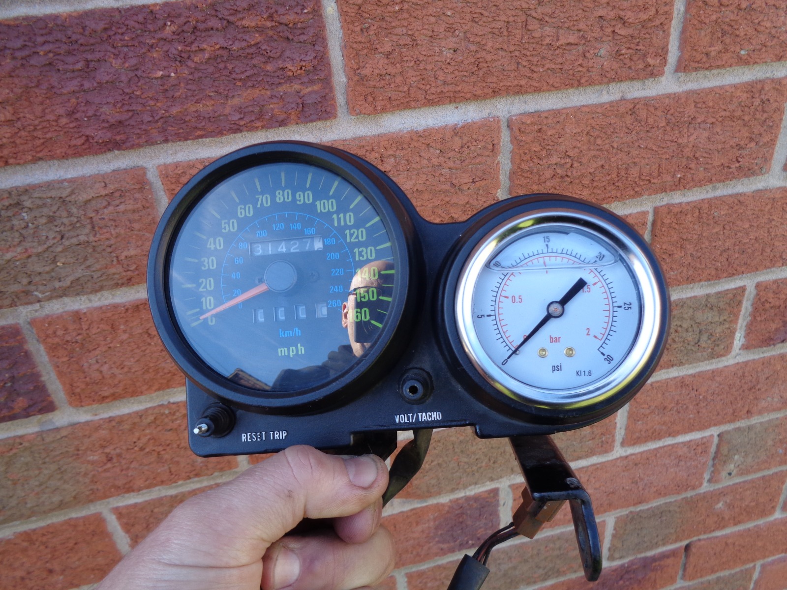

Ah well !
The problem solved itself.
The bloody glass cracked and the ring remains solid .
Luckily the gauge is a perfect push fit in the ring so that's how it will have to be.
Not keen on the chrome bezel which i was hoping to hide by fitting the gauge in from underneath but it will have to do for now and i'll see if it grows on me..

- Posts: 6554
- Thanks: 4141
Re: GPZ1100A Unitrack dash glass removal.. Anyone know how ???
06 Apr 2026 07:48
Looking at your pictures that ring looks like it’s bonded in !!

If the chrome does not work for you, you could paint it.
07 Apr 2026 04:10
You got lucky with such a nice fit!! The lens was glass? You can have those made of course if you're wanting to go that direction. The only plastic shroud gauges i've ever done were on the first year Suzuki GT750. The ones with the black plastic upper and bonded-in acrylic lens. I think it might grow on You, it's a performance thingy! Great Job!
