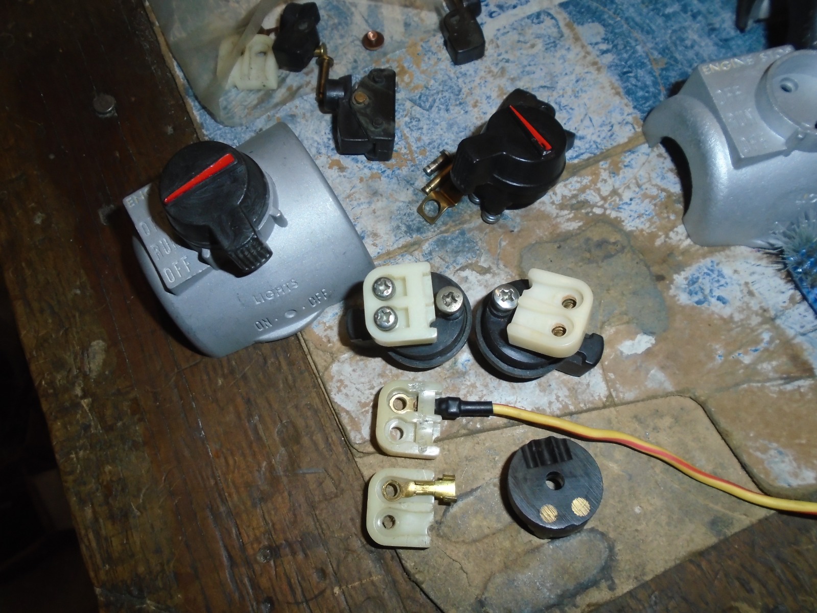

Three little 3mm screws and the RH upper switch comes off as assembly. Pop off the E-Clip and you'll find 3 springs/halfmoon brass plate and that ball bearing. Here's photo of what they look like. Ya got it for the best price, put some elbow equity in it. No Totally Free Lunches, ha. Let me know what You need, have parts ya can't find out of any Kawasaki Catalog!

Persons are pushing you to the darkside, ha. I hate the darkside, aka, repop aftermarket, heh. Show a picture of controls and connectors when you get a chance, I've containers of them plus replacement bits if not adequate.
