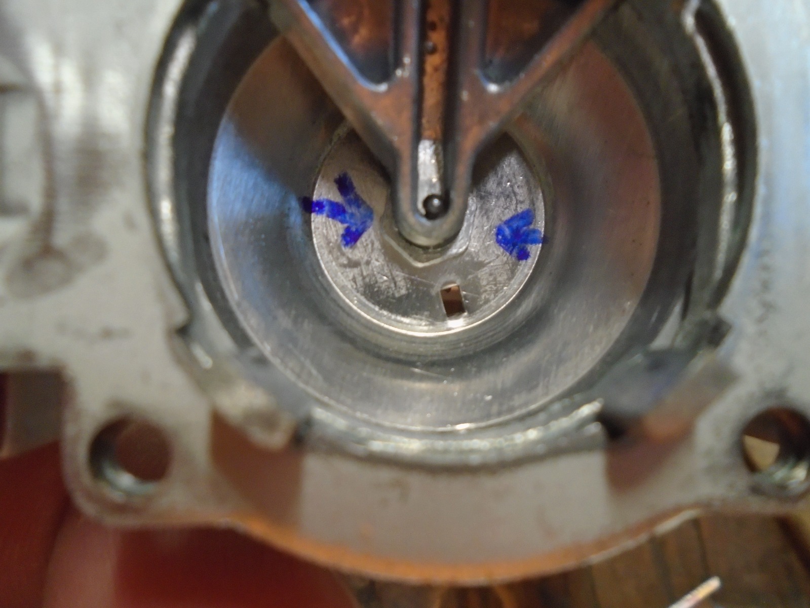

#921709

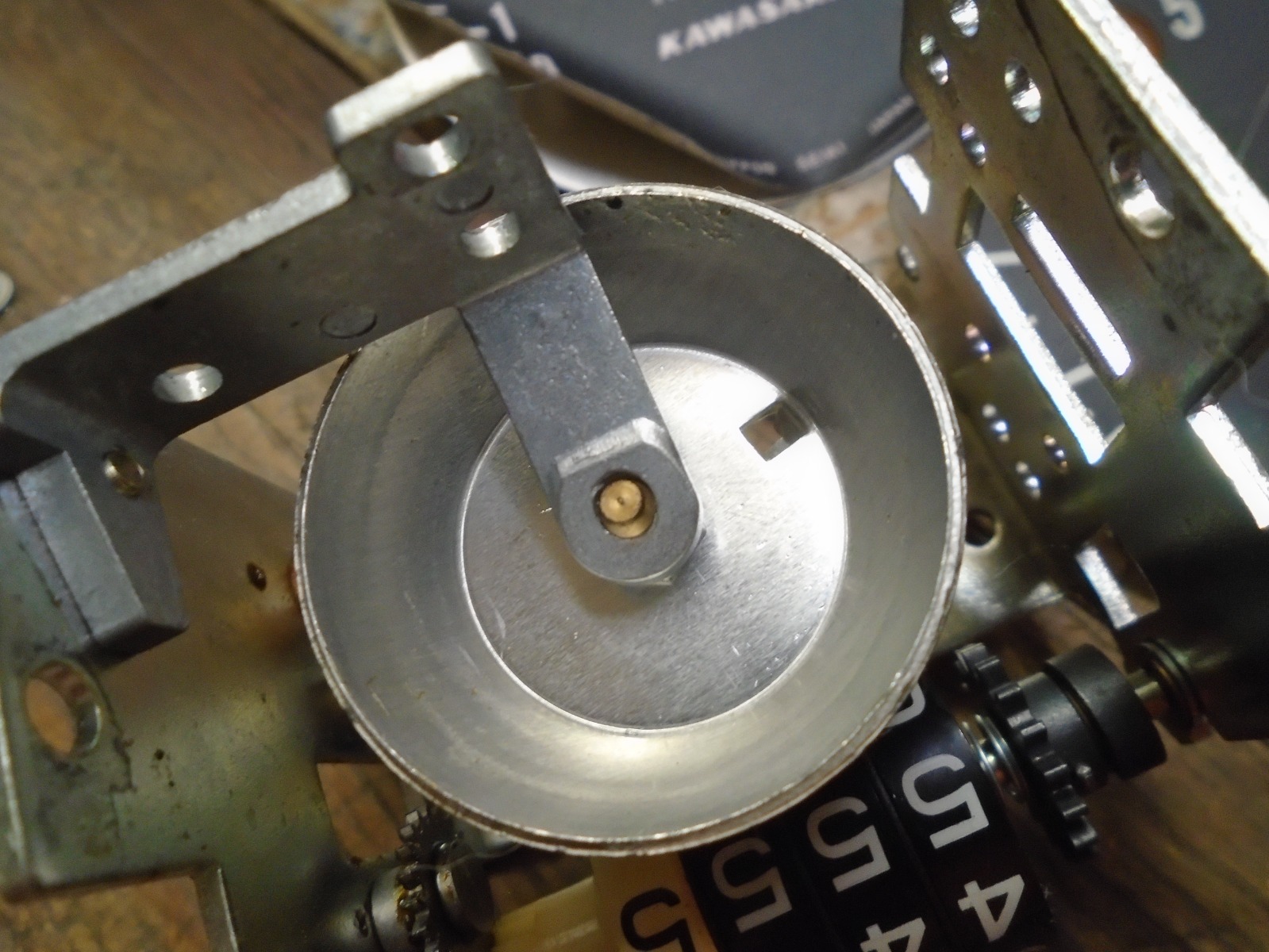

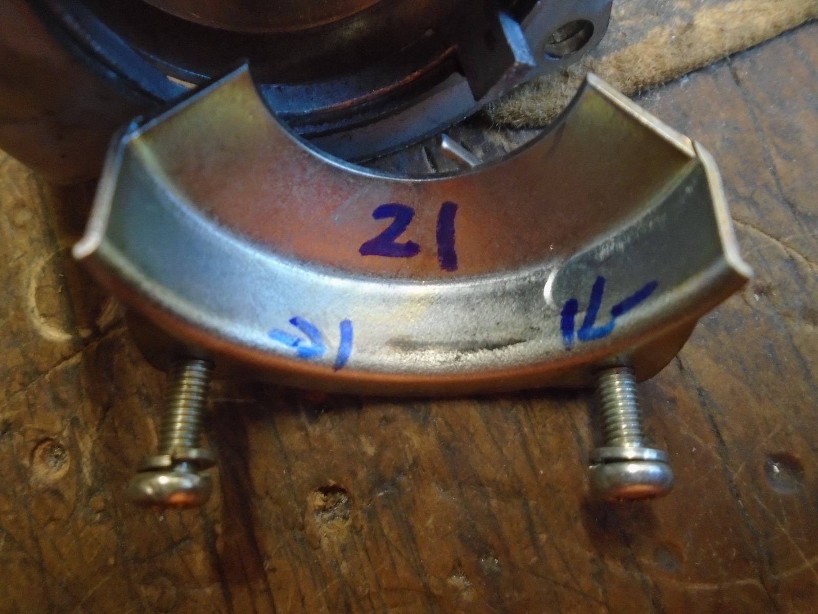

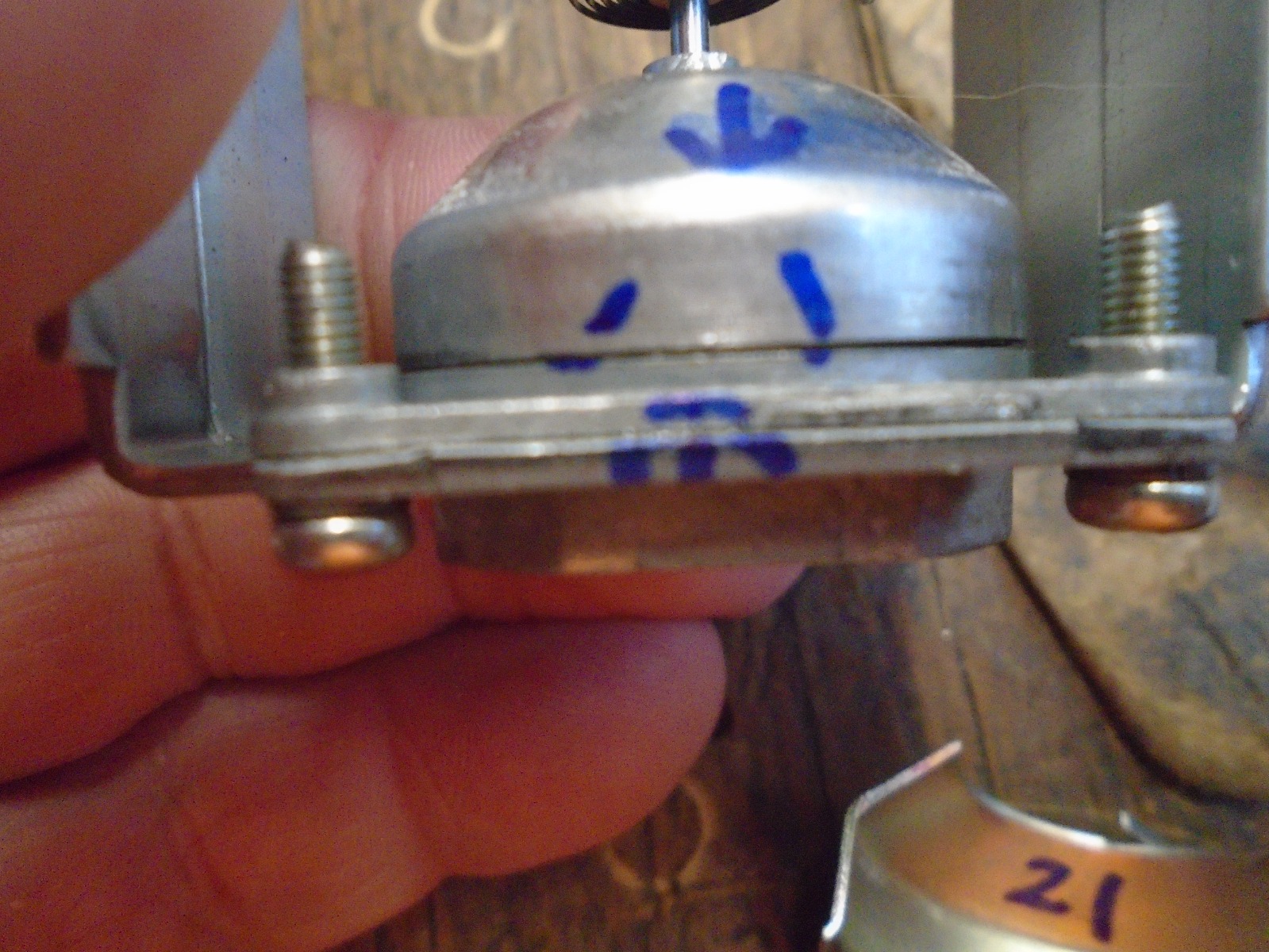

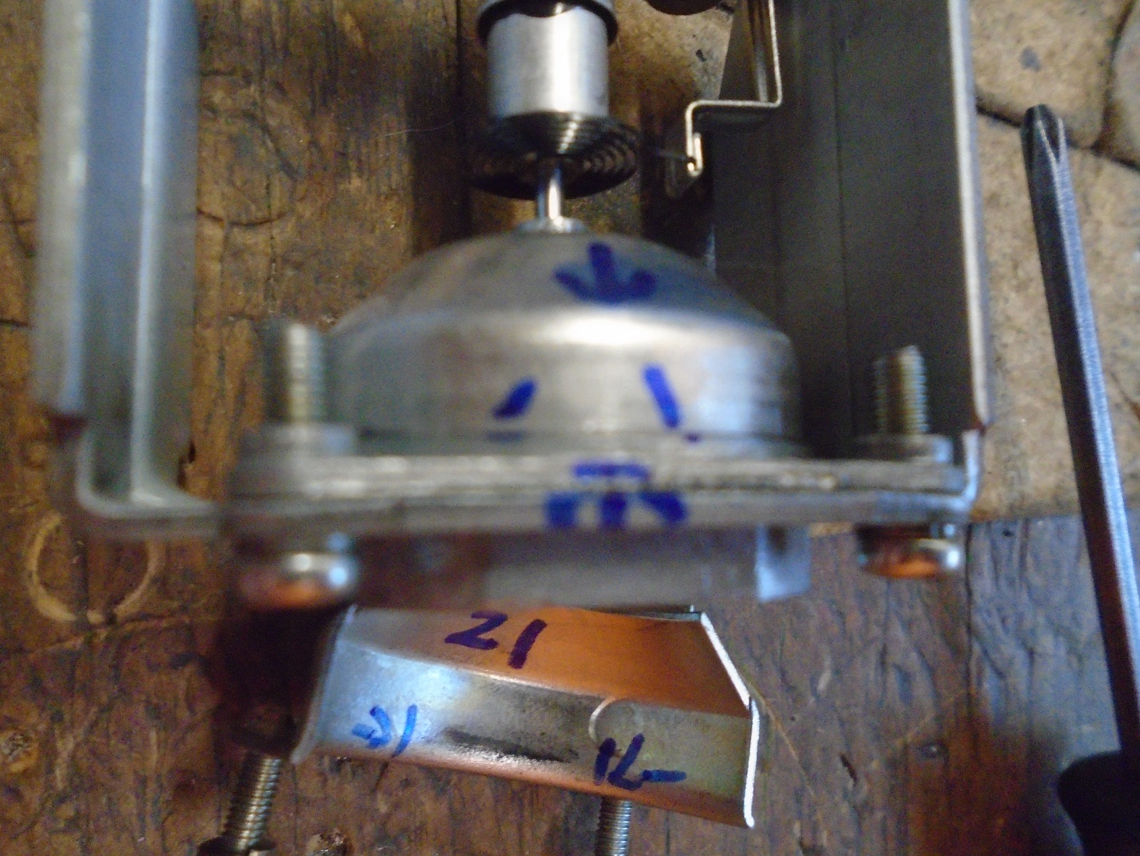

While i'm fiddle-farting around with a couple sets of Z1 gauges, i took some pictures while everything is apart. Might get a better understanding of common issues with these and why they misbehave. This chronicle will explore "why is my gauge spiking erratically". The cast hole for needle shaft support is worn out on this one so it's a prime example, photos of understanding provided. When the cast hole is badly worn "enlarged" the drag cup will rub not only on the half tin bit shown but also on the lower cast support that has that hole for support. Note these shafts are NOT end-play controlled by this casting but by a couple E-Clip brass stacked and sandwiched up top. That's why i deplore the "spoon pointer removal" technique often touted, you distort these tiny little clips. Anyway, note the blue arrows and witness mark left on that half shield. Good Luck!

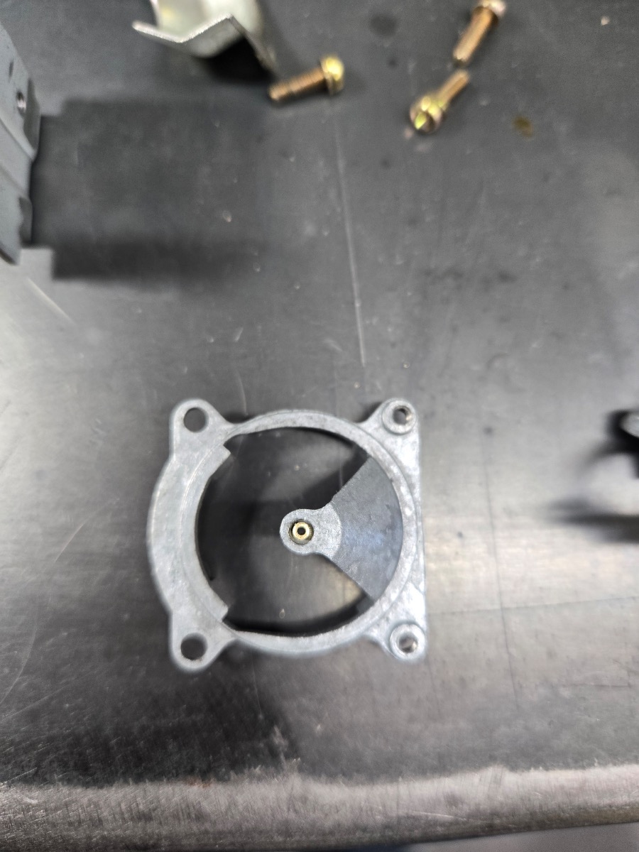

Clay that one is very worn. Here is my fix on one
