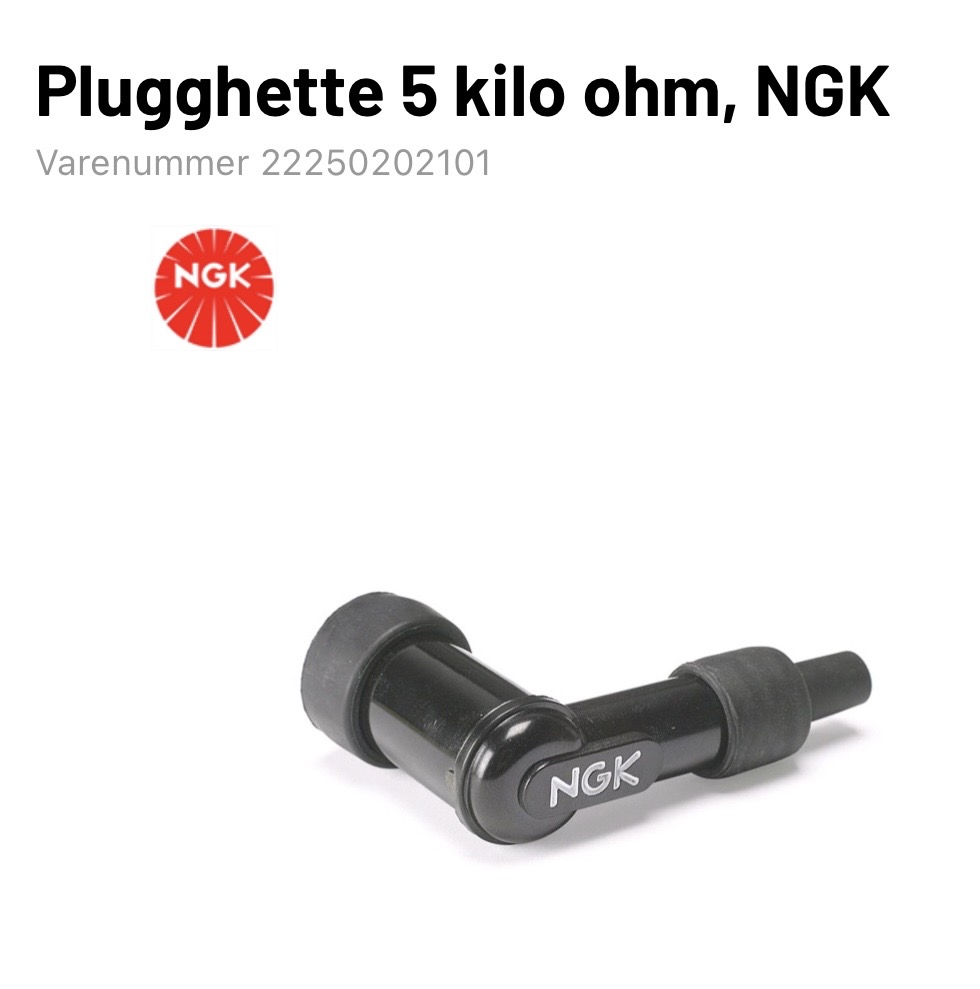

I have previously run the ignition system without any resistor in the plug caps or wires, and it worked perfectly.However, last winter I rebuilt the wiring harness and installed an m-unit blue, so I now want to add a resistor to reduce electrical noise.
Is a 5 kΩ resistor plug cap the correct choice for my setup, and will these NGK 5 kΩ caps fit my existing Dyna 7 mm copper-core ignition wires?

01 Feb 2026 11:14Yes, and yes.I have previously run the ignition system without any resistor in the plug caps or wires, and it worked perfectly.However, last winter I rebuilt the wiring harness and installed an m-unit blue, so I now want to add a resistor to reduce electrical noise.
The OEM wires were 7mm copper core, and the plug caps were 5k resistance. You are exactly duplicating the OEM setup.
