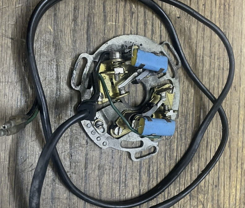

If your handy you may be able to adapt GM automotive points and condenser. They use to sell points plates for 650's and 900's with those mounted under the name "Maxi-Dwell", but points for a V8 might outlast the bike!

27 Nov 2025 05:09 - 27 Nov 2025 18:11httpsTaiwan has been a manufacturing powerhouse for a very long time. Most if not all higher end bicycles are made in Taiwan to a very high standard.
I would trust a part made in Taiwan over China always.
/www.ebay.com/itm/134361402134

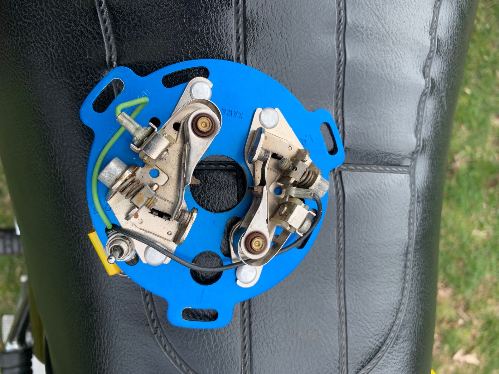

27 Nov 2025 09:40Here’s one for a Z1, from 76, fired right up after 35yrs asleep, he’d some issues, went back to stock, now using 83/84 1100 ignition

27 Nov 2025 11:19What model is that ignition plate picture from?
Its not 76 Z1. Where's the condensors.?
Never seen a ignition plate like that on any kawasaki I've worked on.

I agree, what is the switch for

27 Nov 2025 13:00 - 27 Nov 2025 13:01On the Maxi-Dwell the points plates were made from aluminum and the condensers are mounted on the back of the plate (that yellow on lower left) the toggle switch goes to a light to set the timing without extra tools. You can just barely see the tiny bulb behind the black wire in that round opening.What model is that ignition plate picture from?
The point used are GM points off a car or truck engine. Everything but the points were proprietary.
