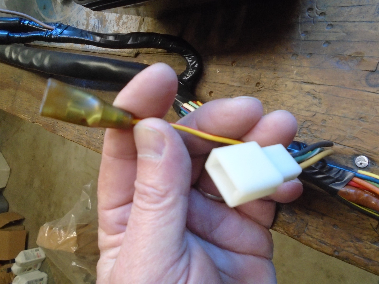

In an original harness the coils are powered by a yellow with red wire from the kill switch to the coils.

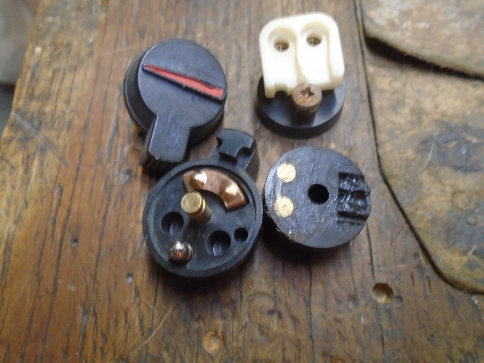

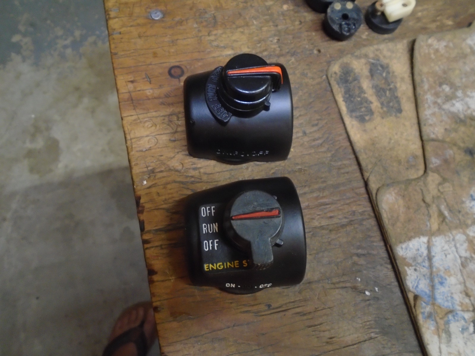

There's not "directly" any ignition wires within the headlight bucket but there is the power source for ignition there. The Brown wire coming off the 4-pin ignition switch routes to your RH switchblock, this is the + and goes directly to the upper portion/half of casting or ON/OFF/ON selector knob. The half moon looking brass, 2 spring loaded, piece slides across the two contacts on ramp plate. This half moon brass contact disperses + to the starter and coils. So in theory if Your starter functions then you "should" have + power to your coils via that Yellow/Red double female connector underneath the tank. Double female 4mm terminals btw. One for each source + per coil. Coils can pull a bit of power and if that mentioned "half moon" plate isn't nice and clean then the supply "can" be spotty and intermittent/weak. That's why it was mentioned about the "wired George relay" thingy. I've actually never have seen a real reason for it because i go thru ALL the switches initially as to deter any voltage drop anyway and have never had a problem. But persons do it to compensate for weak links? Check supply at that double female for positive to ground and note any funky behavior and tightness of the bullet connectors when inserted. A couple photos of front/back of your switch if proper 1975, they only used that upper casting in 75. The earlier Z 1972-1974 shown right above it in photo.    Engine Stop Yellow font on the bottom and what to expect if you're cleaning it. Have Fun, Clay

the kill switch on the handle bar works as it should. with the the switch off the engine will not turn over and will with the switch turned on..still no fire to the plugs
