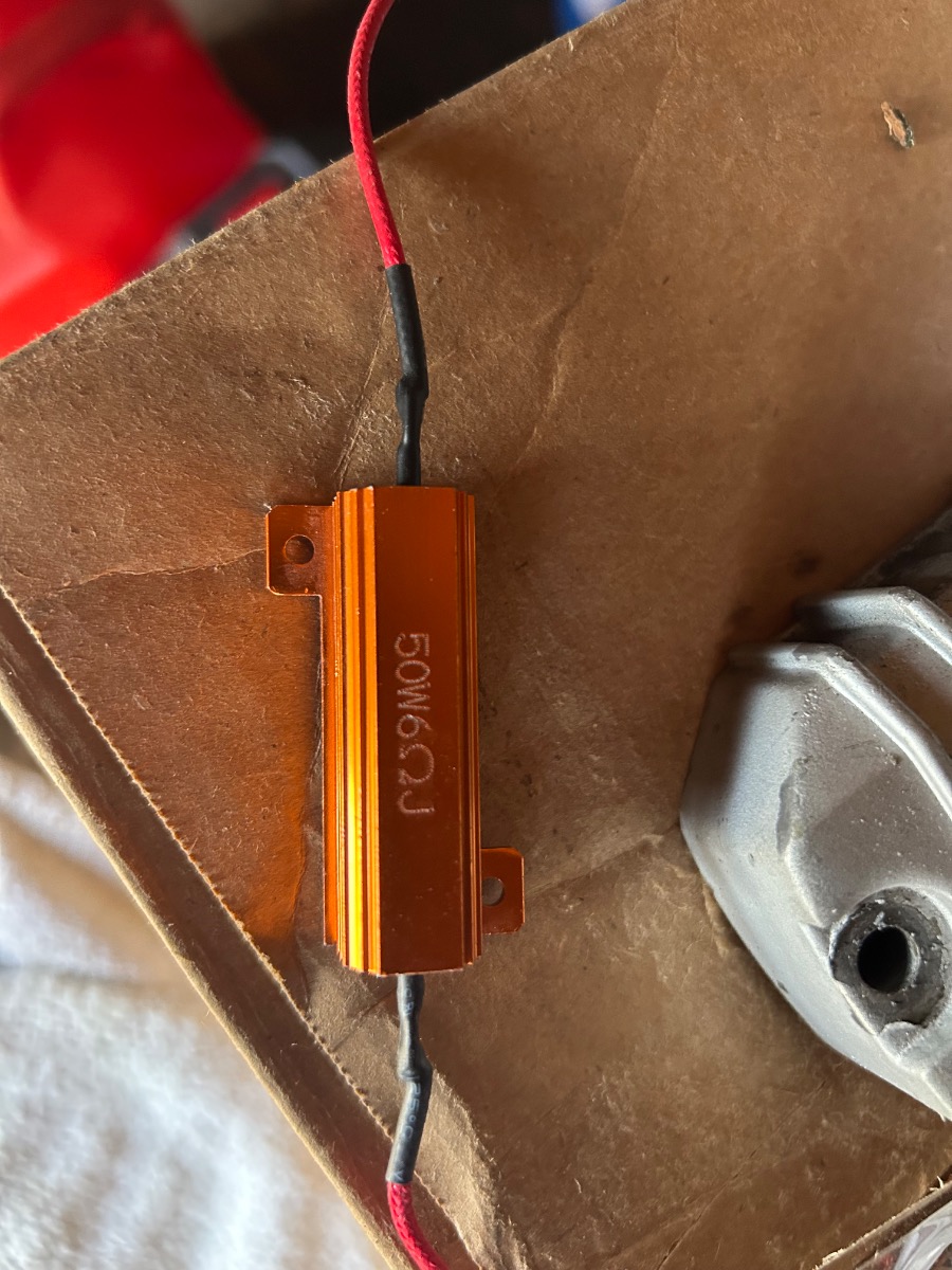

1157 led replacments are available, on Amazon, even have lamps that flash 5 times, then go solid, brake lamp failure unit under tank is looking for incandescent load(resistance), they also have resistors that wire in parallel, to supply that load, will pt p a pic later of resisters

07 Nov 2025 14:48resistor used, Wook this install will stop the warning from functioning, unless the resistor blows, led by itself works but lamp in tach stays on, as led is non filament, one time the fail unit was disconnected, and lamp was on, just assuming it’s looking for a load, and your theory, the results are the same, lamp in tach comes on,
