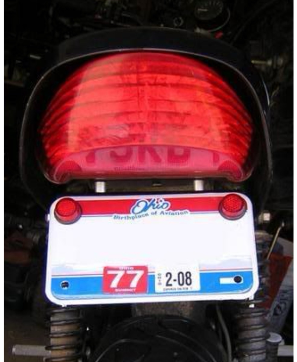

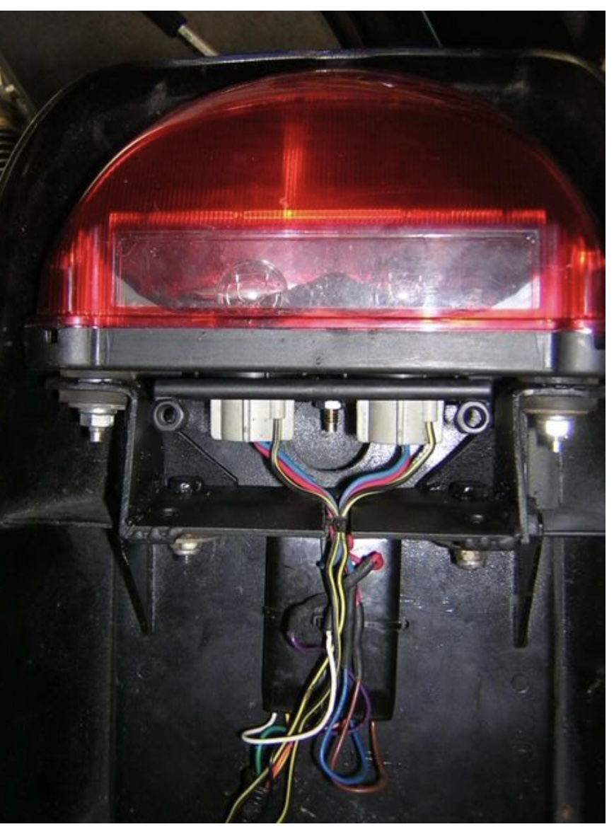

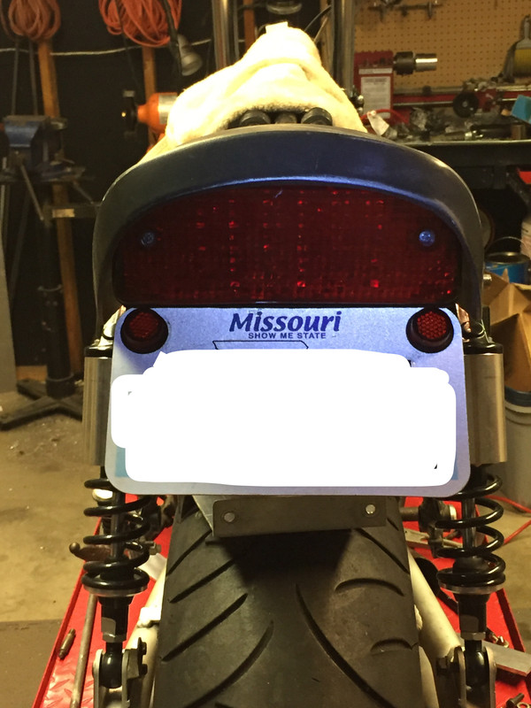

I’ve had two different lights on my ‘78 1000 (same tail shape as a ‘76 900A/B tail).
First was a Zx12R taillight. It looked OK, had two bulbs so I could run a taillight integrator and the lens was clear underneath for a license plate light.

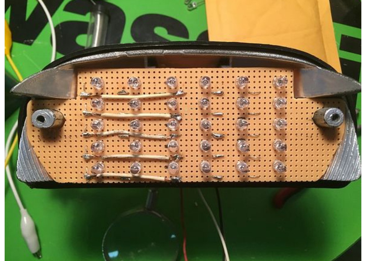

My latest light is from a HD Fatboy
of some sort. It fits the tail section much better in my opinion. It has a single bulb but I made my own LED taillight with running and brake light functions.
Both lights required custom brackets.
Later, Doug
Later, Doug

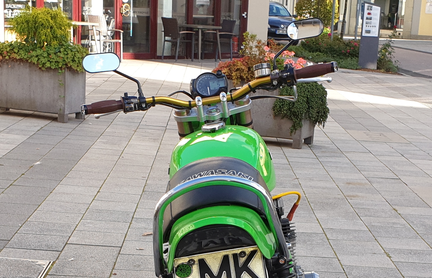

Re: Tail Light Question
03 Nov 2025 07:27
the zephyr 750 tail light might work. but are kind of rare/pricy. also, check the later 2000s zr750 ZR7/ZR7S. but the zephyr is probably a cleaner look. I have no idea how easy either would mount.
