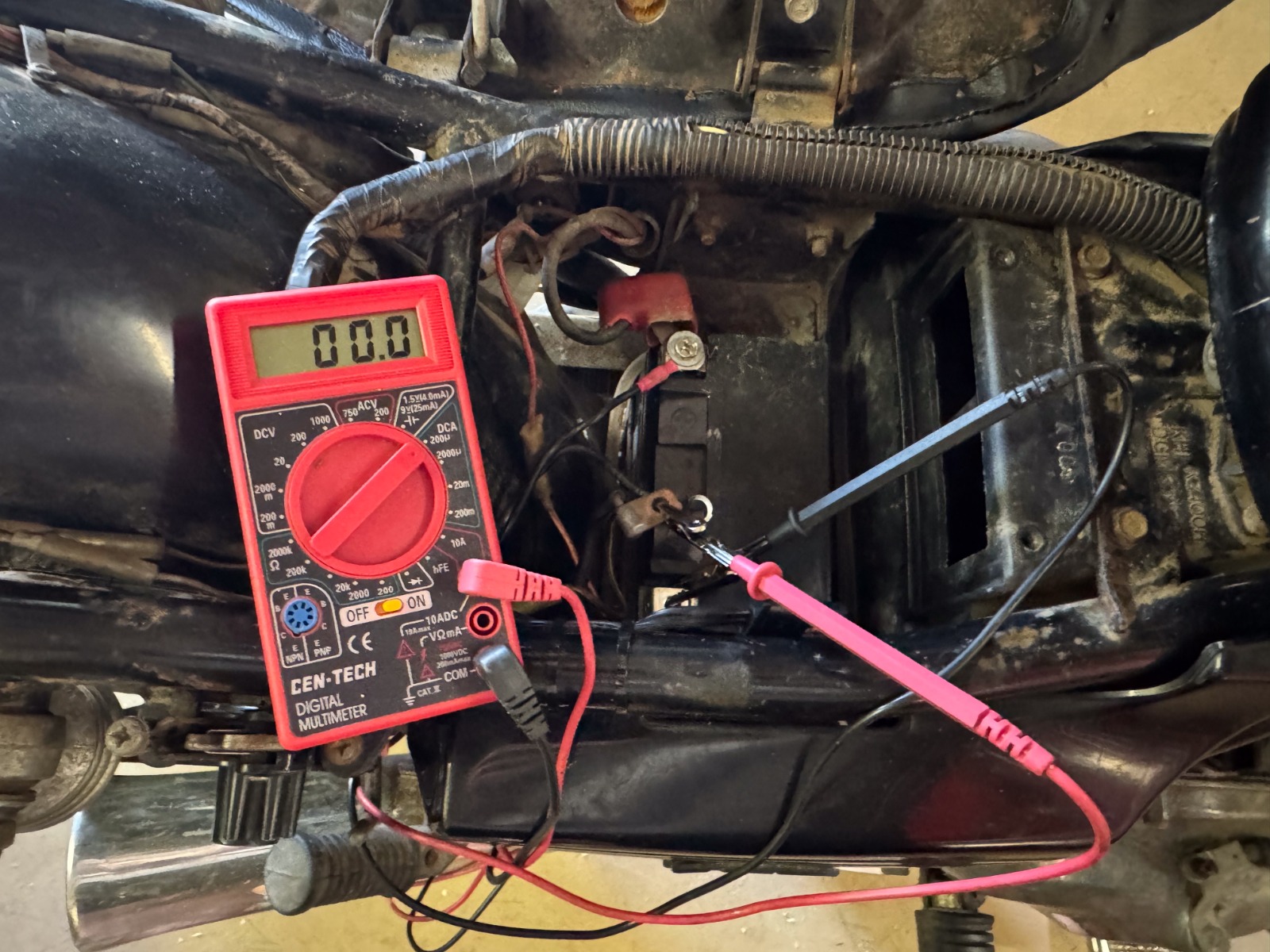

a healthy gel battery should hold charge for several weeks, you may have a drain on the system. If you have a multimeter switch the test lead to the 10amp position disconnect the the battery ground and connect the meter (on the amps setting) between the ground lead and the battery. Do not turn the ignition on - the reading should be zero, any more suggests a drain

26 Oct 2025 07:21Came back at zero amps with ignition off and 6.5 amps when it was ona healthy gel battery should hold charge for several weeks, you may have a drain on the system. If you have a multimeter switch the test lead to the 10amp position disconnect the the battery ground and connect the meter (on the amps setting) between the ground lead and the battery. Do not turn the ignition on - the reading should be zero, any more suggests a drain

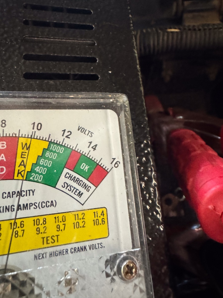

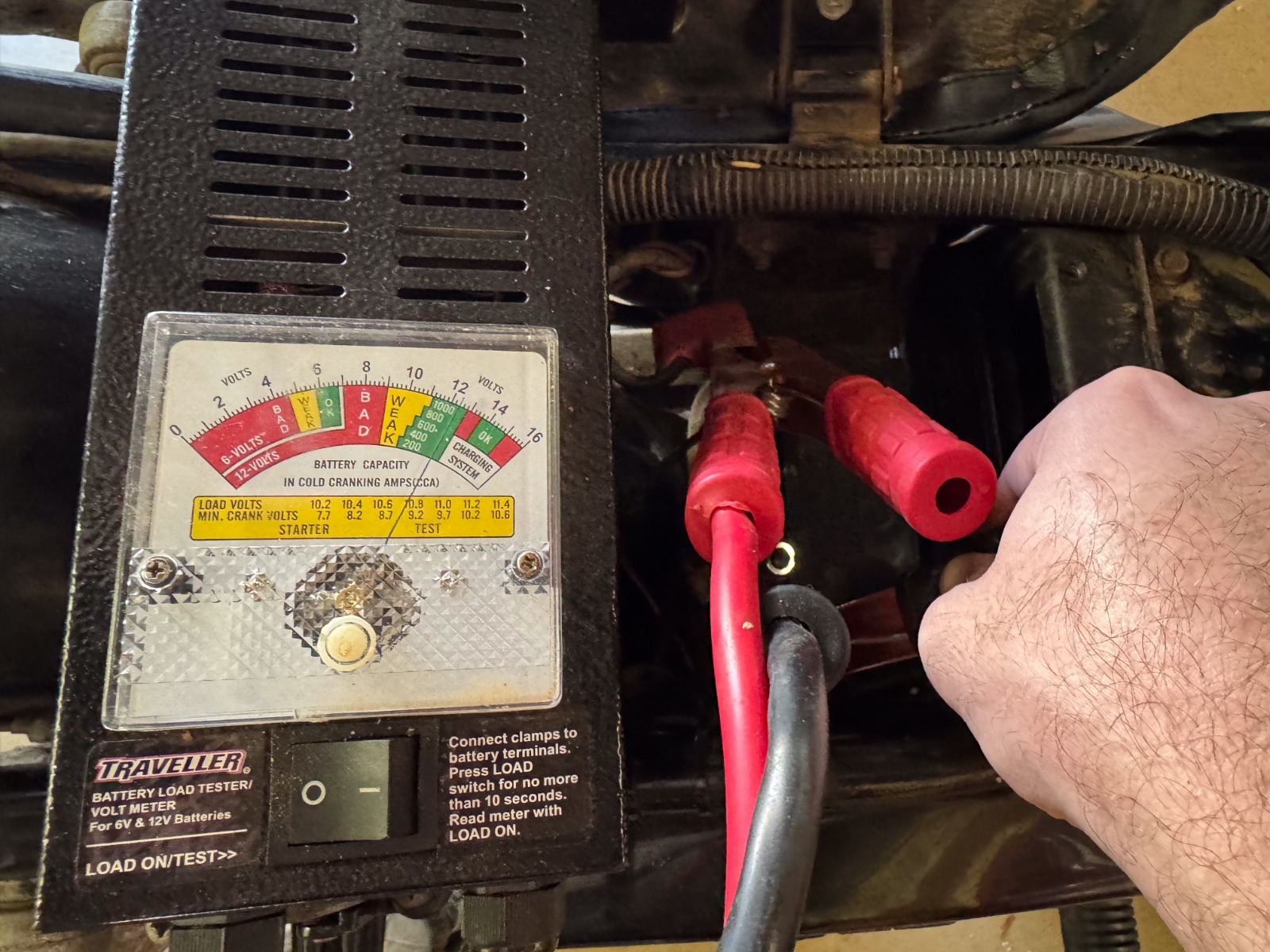

I do have an old battery tester that was my grandfather's so I gave that a try and the battery did come back weak, so maybe the battery is just cheap and dying already at only 475 days since purchase.
