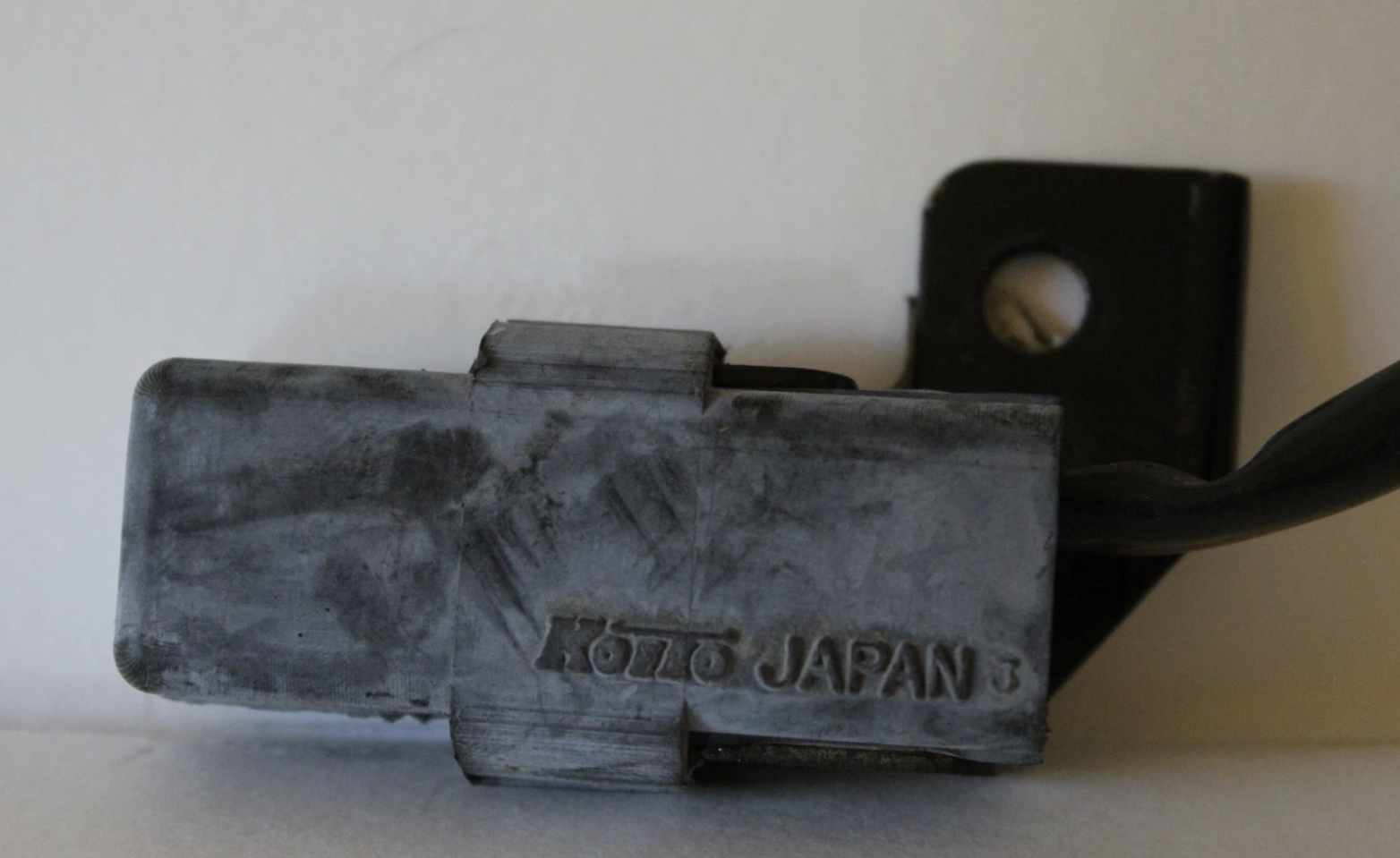

What does the fuel check switch bracket to? I looked at the diagrams and I'm still not for sure. Am I missing a bracket?

Sure it's a fuel check switch?
Looks like a brake light outage unit fitted to later 70's khi bikes.
The brake light outage unit causes the brake idiot light to flash if the brake light bulb filament blows warning the rider he has no brake light.
These were fitted under the tank on bigger bikes and to the rear side of the electrical component plate on smaller bikes.
Whatever it is check those two places.

The wiring harness sort of puts it under the seat. I don't think the way it connects to the harness that it would fit under the tank. I appreciate the help.

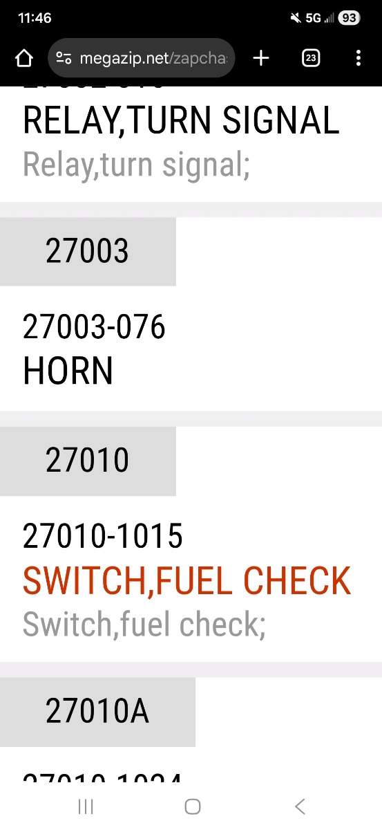

21 Oct 2025 12:12Have you looked at the "test procedure" in the manual (these generally say or show where the component is located)The wiring harness sort of puts it under the seat. I don't think the way it connects to the harness that it would fit under the tank. I appreciate the help.

Thanks for the help guys. Yeah I dont think my bracket has that part. The bike was sort of pieced together when I got it. Ill have to look for the other bracket. Looks like there were two brackets optioned...

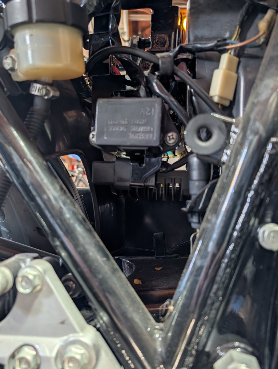

what 750 is it? ... photo under the LH side cover of a 1981 kz650-csr. in case yours is an Ltd. it might be the same. part A in the photo may be an outage indicator switch. similar to the fuel check switch.

I bought that bracket and put it here. Seems to be correct. Thanks to everyone.
