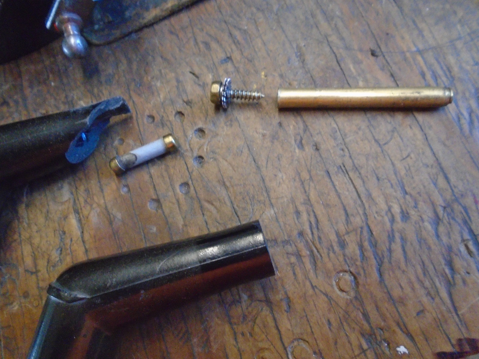

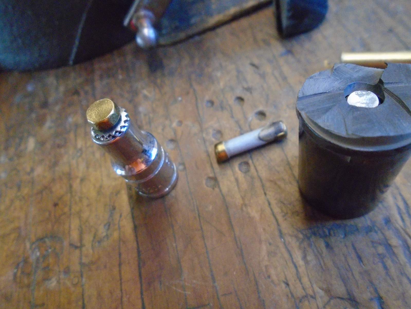

Some of those NGK plug caps have a mechanical "resistor" just like the spark plugs with a "R" designation. You can easily take the resistor part out on the caps and plugs, its a ceramic wire/plug. No need to order new parts, just look on YouTube for how to remove video.

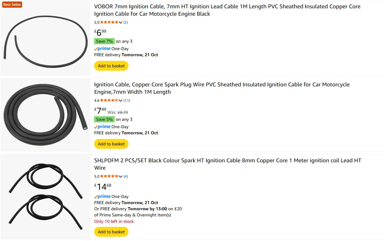

I have stock igniter. I tested them and they are in spec!! I cannot tell about my wires, I guess they are stock one!!  I cannot find good price on ebay for 0ohms wire !!?
If you can't source locally and want to buy on-line Amazon have a selection of 7mm and 8mm copper core HT lead

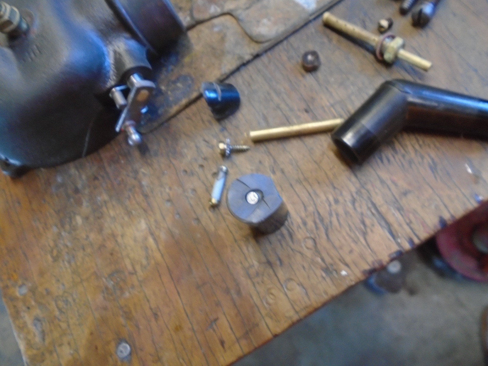

Something or another avenue if you choose. Because i maintain original parts, i just service the original caps. Yes..they too come apart, just have to know what you are doing. Unlike the NGK which ceramic resistor is easily removable, original caps are a bit trickier but still doable. Replacing the resistor with a simple slug upon re-assembly always an option. Food for thought.

Thank youu!! It gives me an idea how to disassemble the cap 🙂
