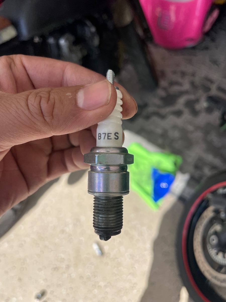

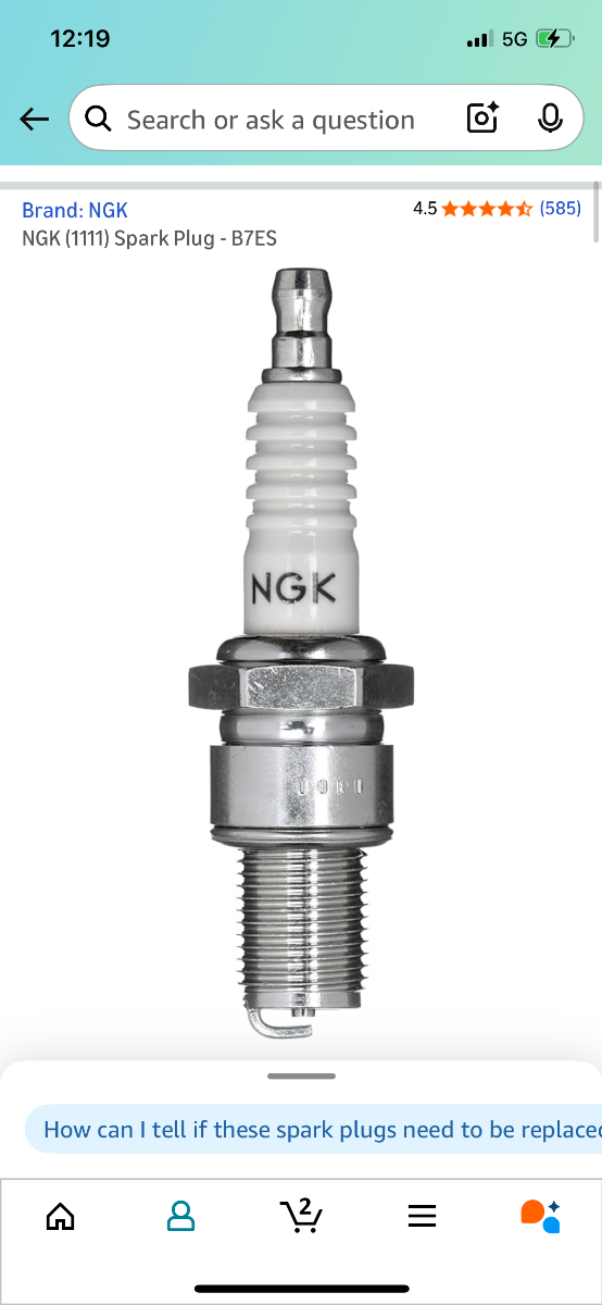

Hi all, Was trying to replace my old spark plugs but when I got the model that I "needed" it had a different tip? its more hollow than having a point at the end?

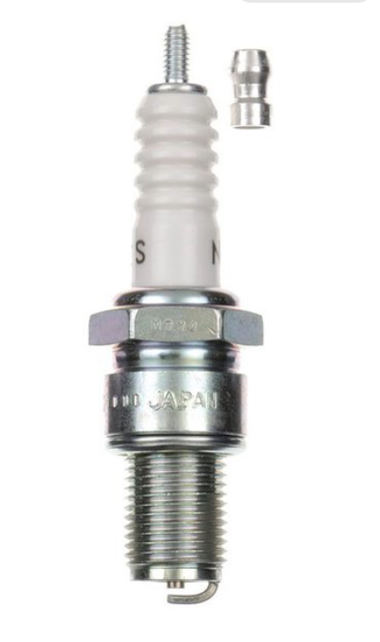

Sadly, NGK discontinued the old style plugs we need for our KZ bikes. New version are "resistor" type, and many have a different type of end on them. The originals had a threaded end, with an aluminum cap threaded on, which we remove before installing the plug cap.
I'm struggling a little to understand what you have. Maybe post a photo? And BTW, when posting photos, be sure to click "insert" before posting, otherwise the photo shows up as a tiny thumbnail.
These are the type you need (assuming you have the stock plug caps)

07 Oct 2025 11:33No, the cap you can remove is an adaptor for different plug caps - the resistors are built into the plugs (but only if the plug code has an "R" in it) Your B7ES would be BR7ES if they where resistor plugsAhhh, So the new spark plugs you can removed the resistor?
