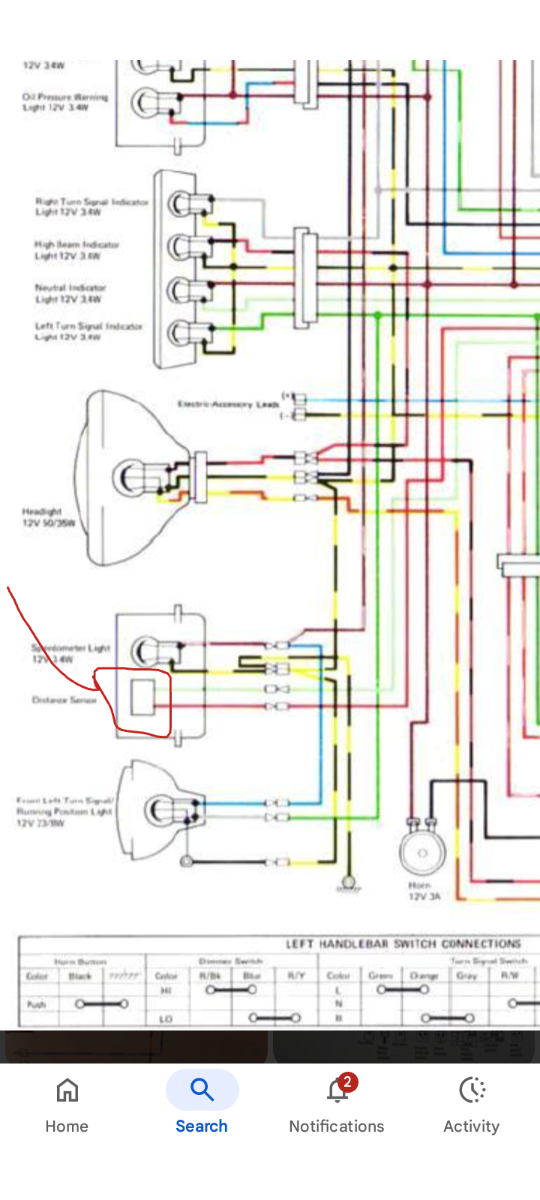

hi everyone first thanks for letting me join ok here is my question i have a 1983 kz750n2 specter and when i got it the speedometer was messed up so i have a different one and i have it hooked up but i have two wires i dont know what they go to one is a solid red and the other is a solid teal color i did find a diagram i just dont know what the wires hook to because now my turn signals dont flash but my hazards do and from what i can tell is that they go to my flasher relay any help would be greatly appreciated i have it circled in the attached pic

the distance sensor is part of the turn signal cancellation system. the wires go to the turn signal control unit. the device would be behind one of the side covers.
edit: 750H Ltd topic. probably applicable for the 750 Spectre >> kzrider.com/forum/4-electrical/618413-au...urn-signal-diagnosis . not sure how much help it will be.

Thank you do you know if there is a way to negate the sensor or bridge it just till I can find a OEM speedo

Does your bike have the switch on the left handlebar marked "off" and "on" or "A" and "M" ?
Did the turn signals work ok with the old speedo ?
You can't bridge the sensor but when the auto-cancelling system is turned off it shouldn't make any difference

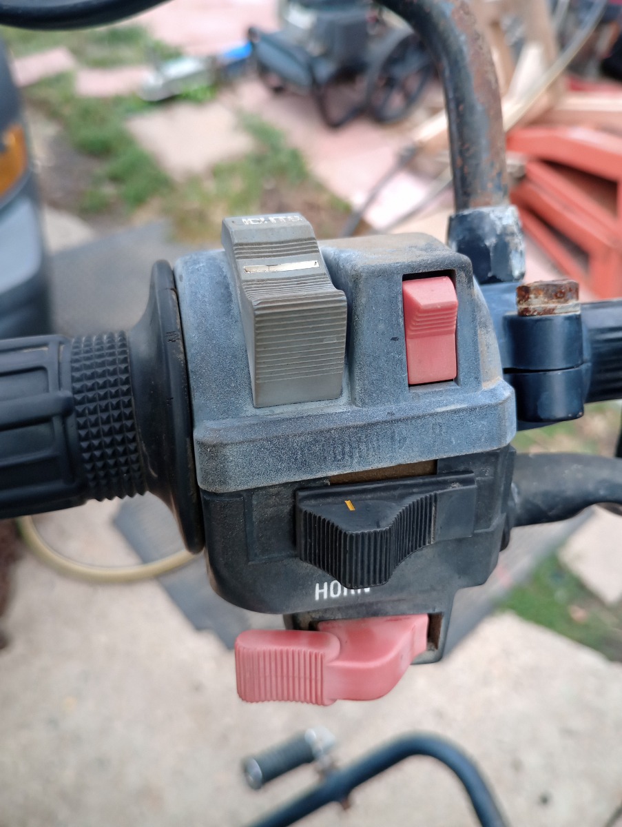

Yes the switch is on the left side of the bars but it isn't marked by off /on nor does it have a A /m it just says turn and as far as I know the did but I am not sure the previous owner broke the speedo off i just bought the bike a month ago

Can you post a pic of the left handlebar switch, I suspect the speedo isn't effecting the turn signals

As I suspected your bike doesn't have the auto-cancelling function therefore you can ignore the distance sensor in the new speedo (switch looks fairly rusty though) first thing to check is with the ignition on do you have a battery feed to the orange wire going to the left handlebar switch ? (check with a voltmeter and everything connected)
