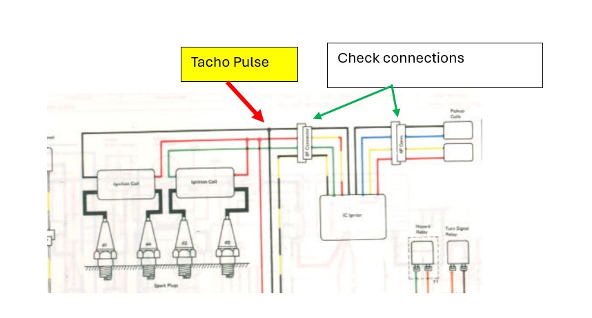

You may find using "google translate" or similar so you can post in English will help you reach a much wider audience

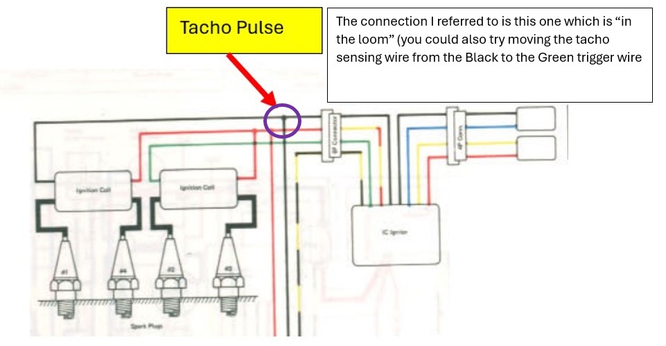

The tacho pulse comes from a "node" crimped connection in the loom for the ignition system. Over time these connections corrode. You could check that
