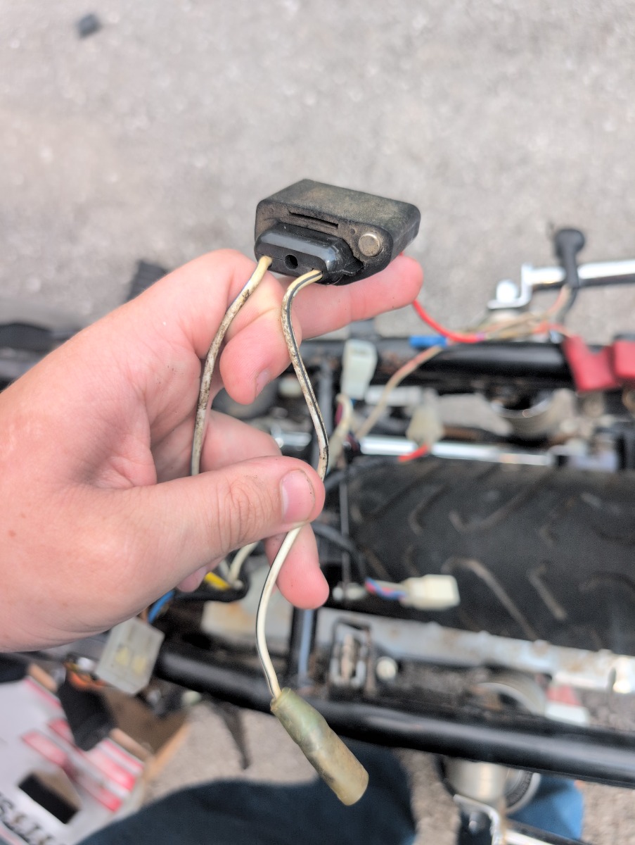

Trying to figure out what the black/white wire that come from a fuse box is supposed to go, bought the bike recently and found this wire without a connection after buying it

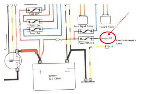

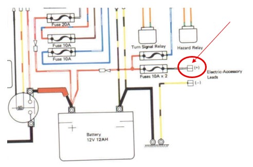

As far as I can tell from the diagrams this is an accessory take off (spare) so if everything is working you are "all good"
