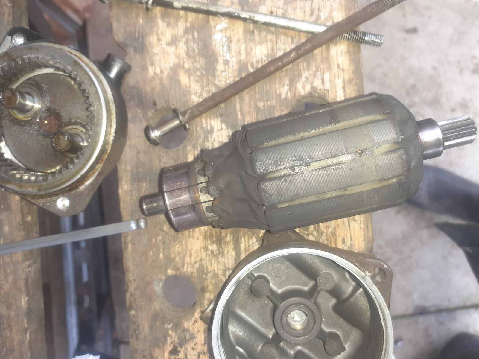

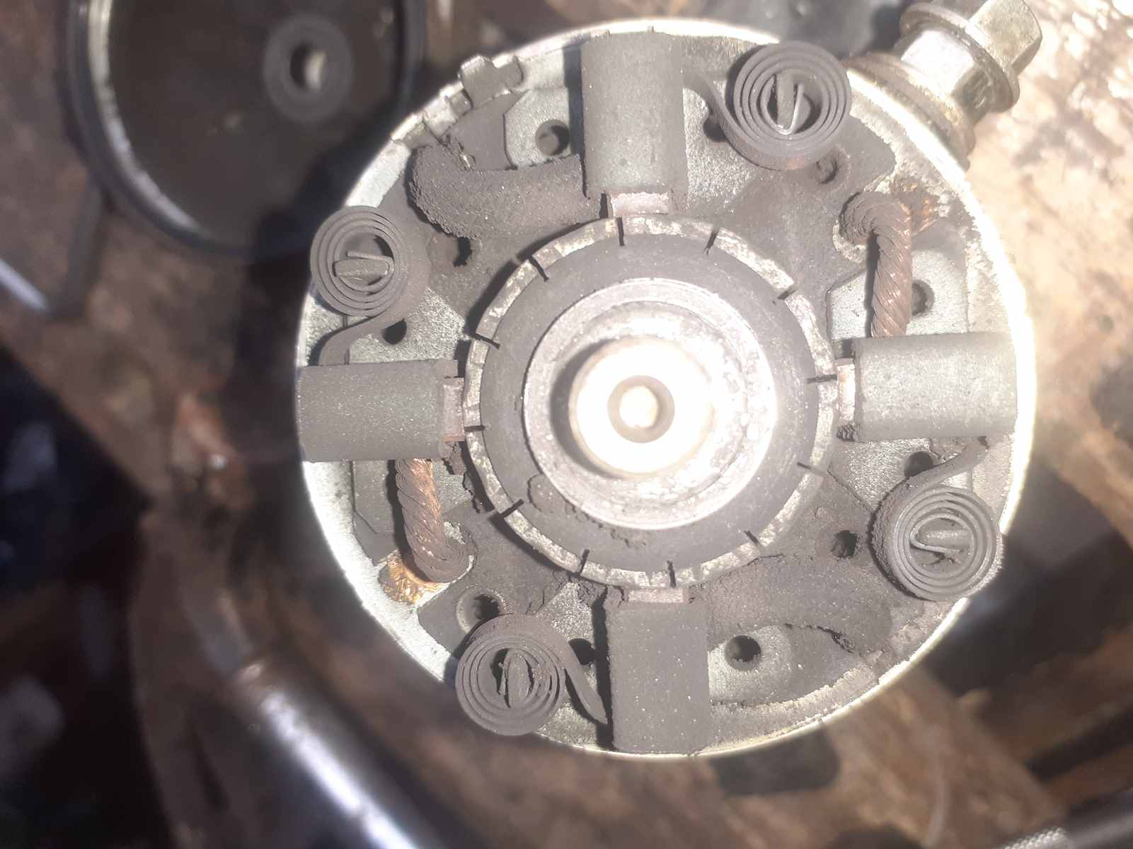

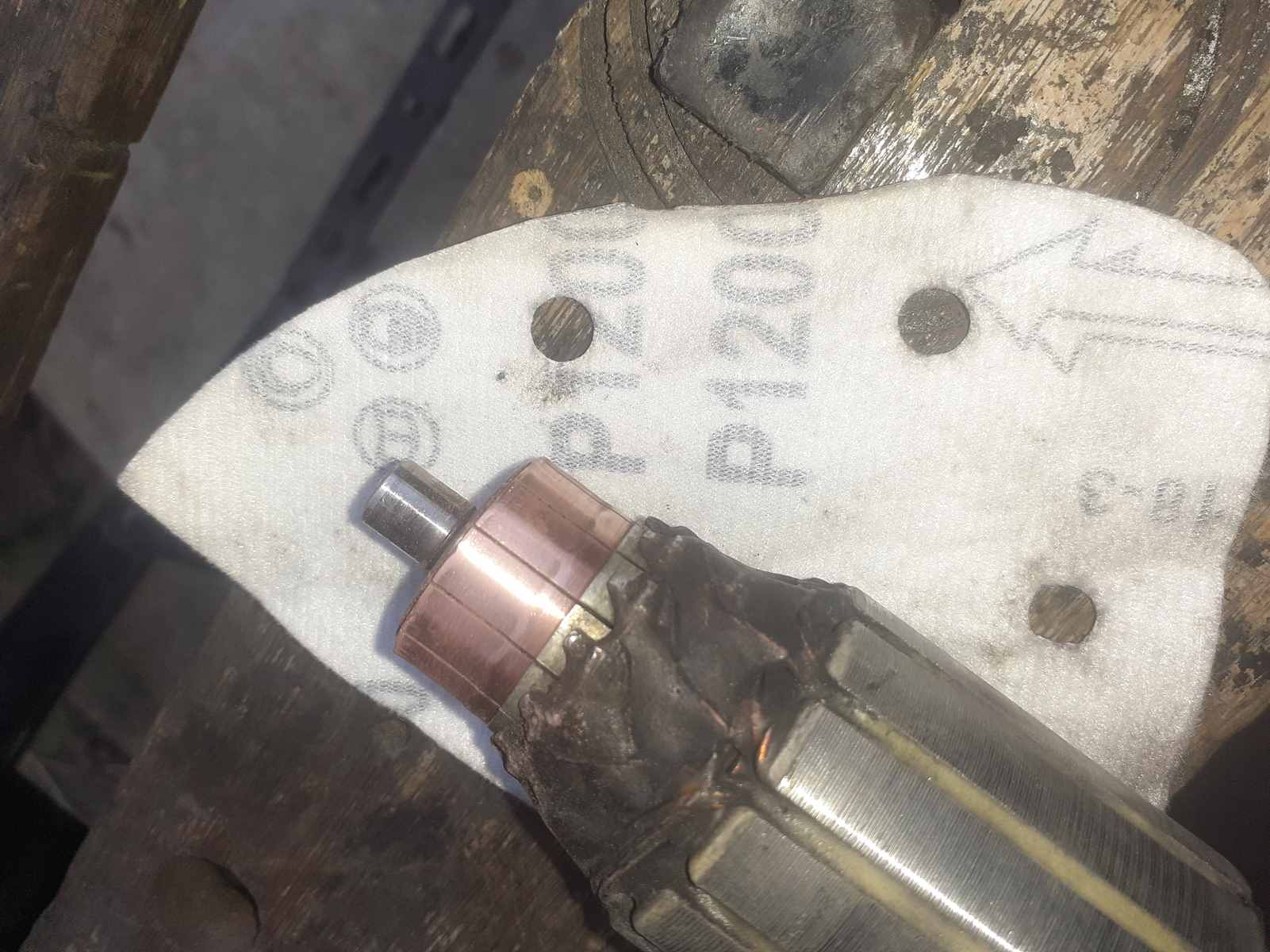

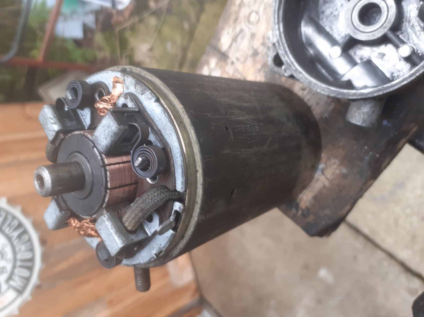

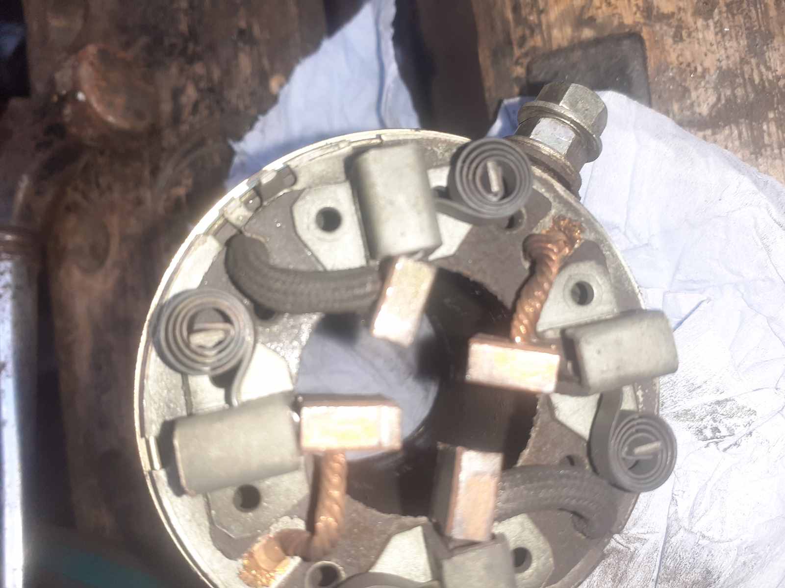

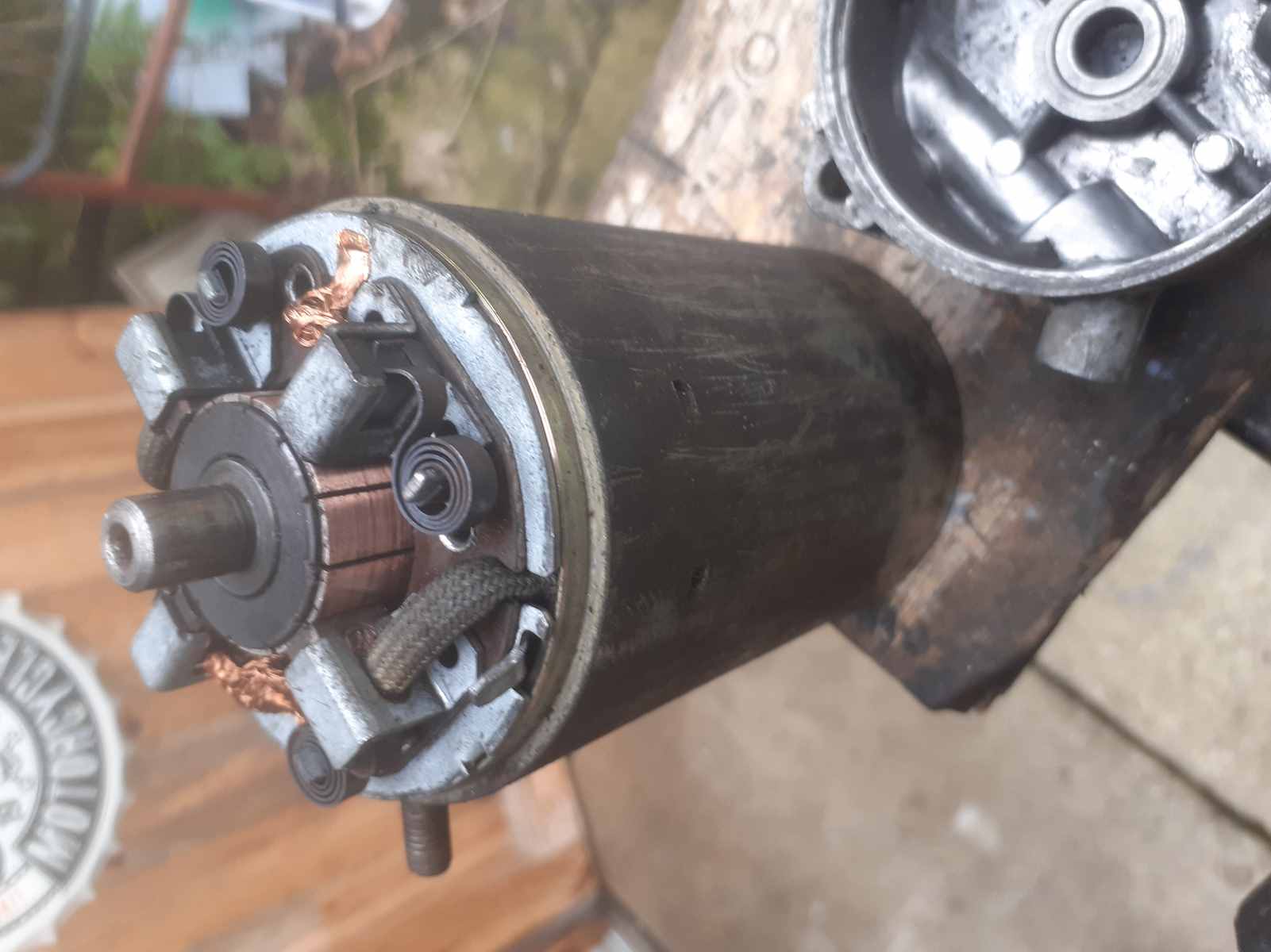

God suggestion. I'we done it 10times. No better funktion. Im out of ideas. Im not sure whats wrong with it. Nice carbon. New bearing. Supergrease.
No better if i connect big battery direct to the starter.
//Erik
//Erik

Sorry for my bad english. Yes I understand that. It dosent make any difference if I put a battery from a semitruck to run the starter so its not lack of power. Its not a bad ground. I have tried with extra groundcables. Im out of ideas.
- Posts: 6940
- Thanks: 4356
Re: Replacement or new starter
01 Jul 2025 15:38

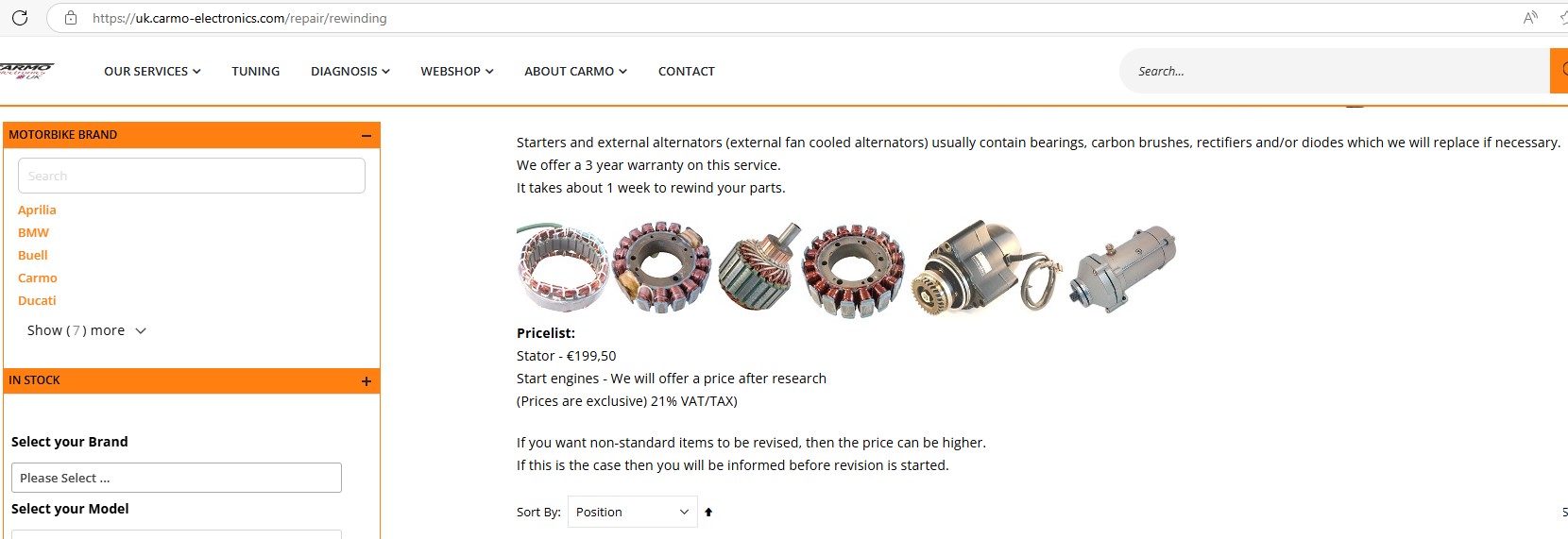

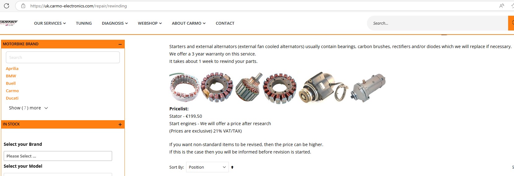

If the supply voltage and the ground are good then the starter is bad. You may be able to find a shop that will rewind your original

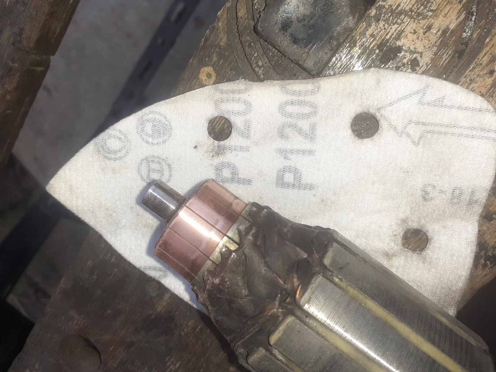

It can simply be that the comutator is worn out .measure it and check spec. If you have a 2 brush starter try to check if there is possible to replace it with a 4 brush that will crank the engine fast even when superhot.

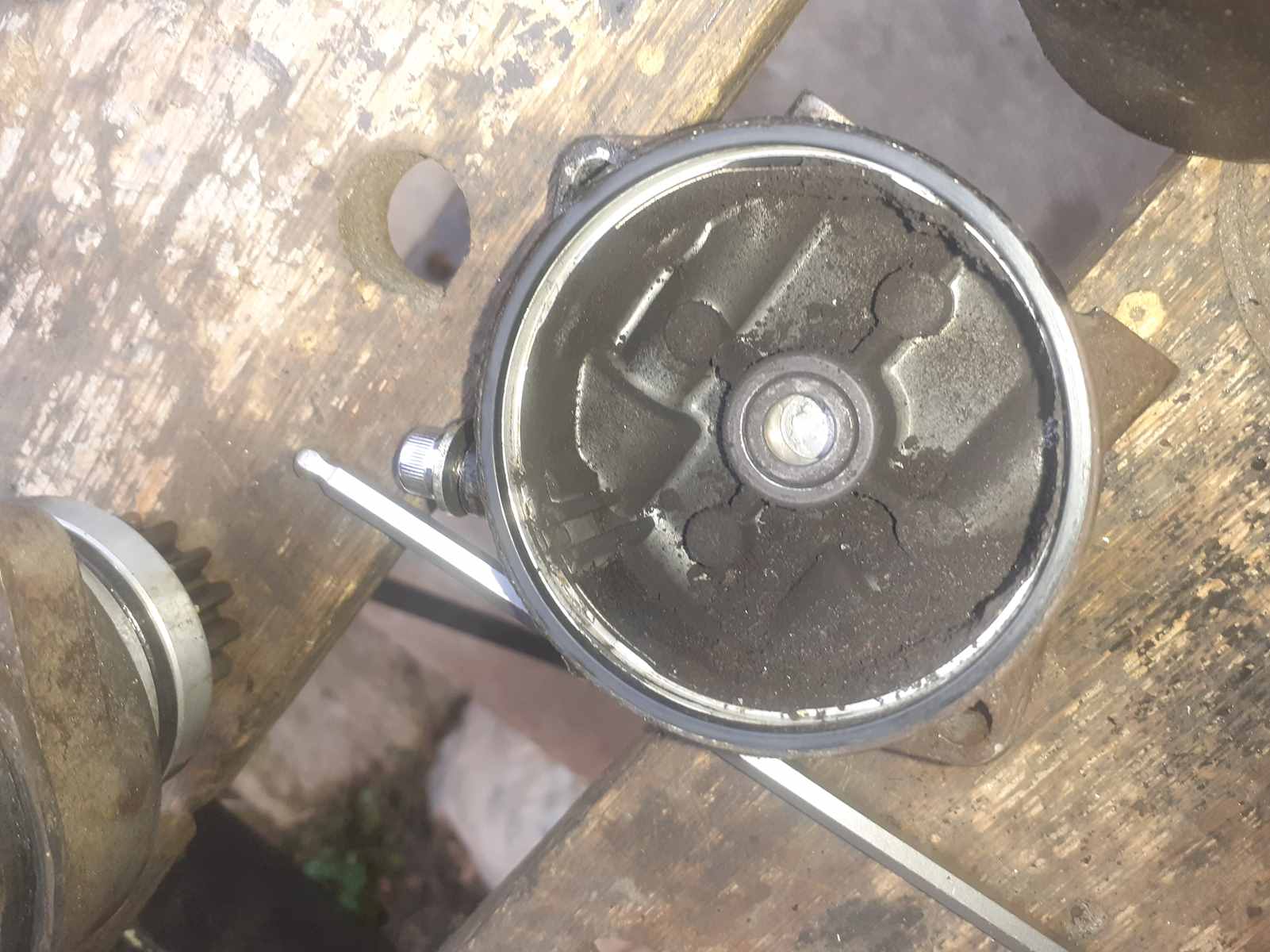

This starter is quite unusual Rolf, it houses a “planetary gear” set which acts as a torque multiplier
