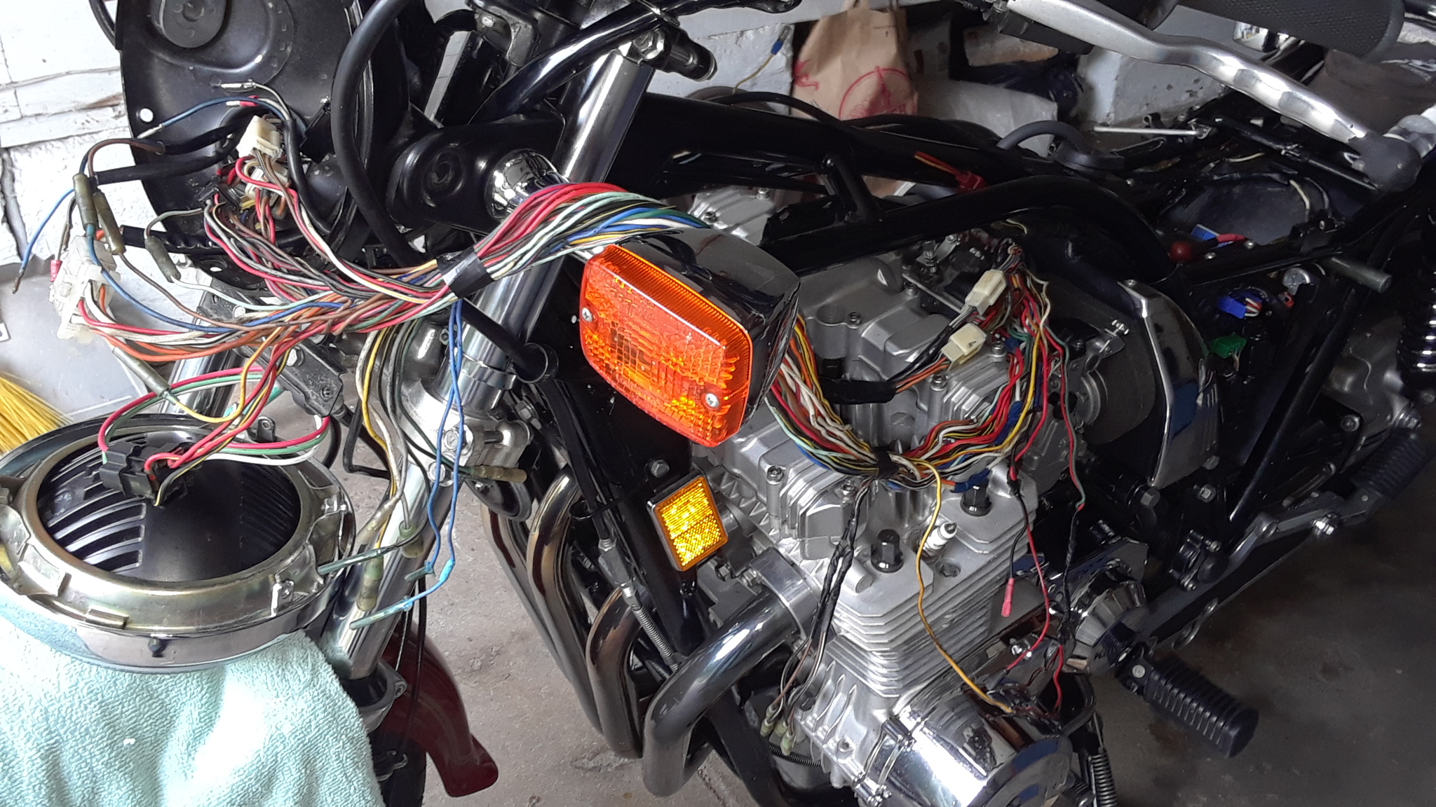

All electrical systems were functioning properly when my engine was started and run for a minute in the driveway before being turned off with the key.
Ten minutes later, turn the key...nothing at all!
Hours later after changing fuses, checking all connectors, swapped in different ignition switch and voltage regulator, then stripped 90% of the black-gooey electrical tape off the main wiring harness to examine the wires...
Bike has a Dynatek 2000 ignition, installed in 2012 has never had a problem...fingers crossed.

This dumb a$$ didn't check the battery voltage with the key on...
Last thing I expected was to have a crapped Bike Master Tru-Gel (black case) battery in it's third year of use, when the previous (with blue case) was still operating as new after five years.
Should have known when a different battery (with the same brand and model number printed on it) showed up than was illustrated on the ebay listing, and I was too smart to send it back.
BTW, is there an electrical tape that won't become a black goopy mess when removed (after many years use), like the 3M Super 33 stuff I wrapped on last time?
