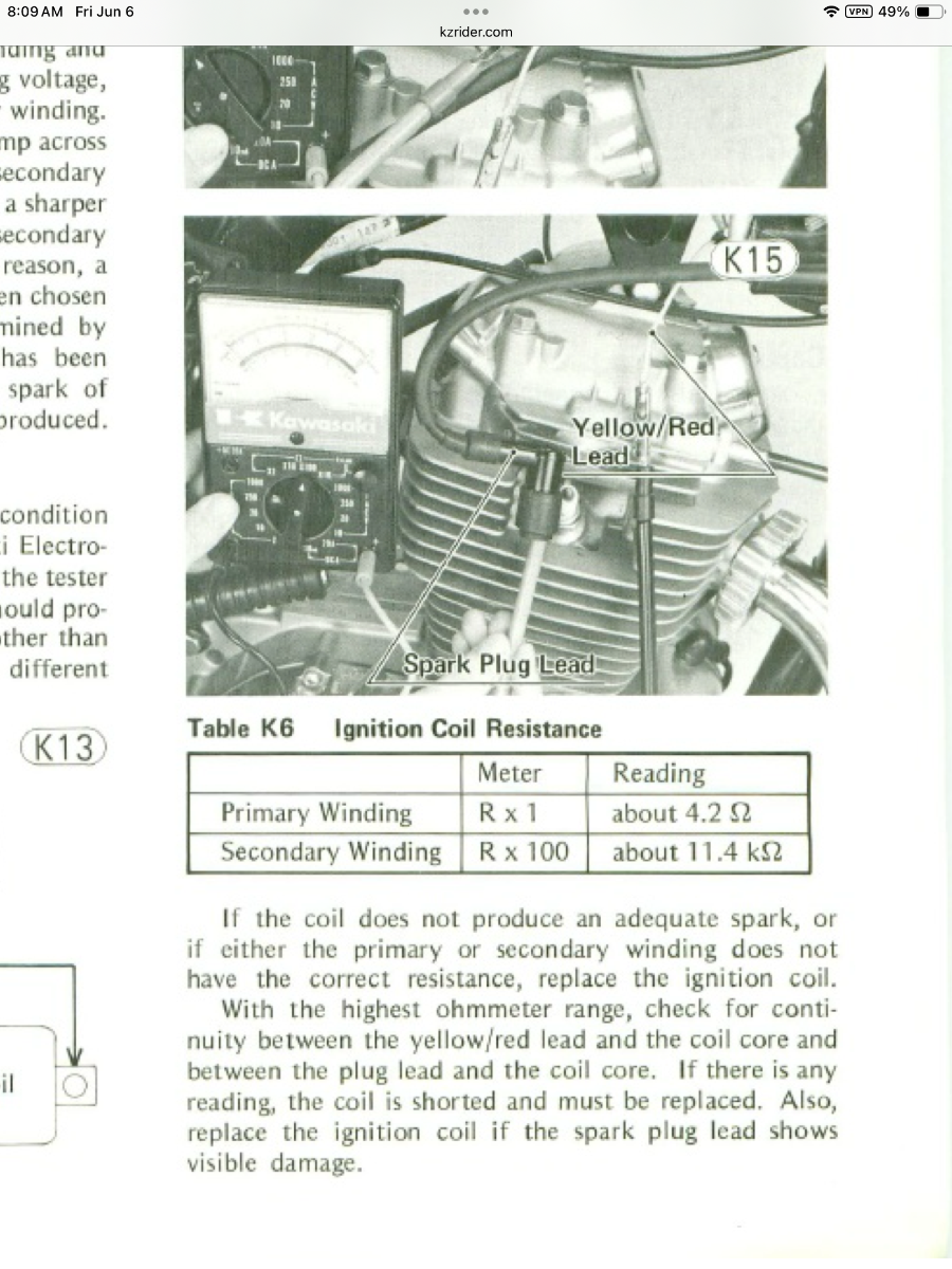

The KZ200, which is an air cooled thumper with points ignition, uses a 4.2 Ohm coil, so I'd bet that your new coil is close enough for your KE. Finding a genuine factory service manual for it would be a good idea.

As it turned out, checking the service manual was a good suggestion. Why didn't I think of that. Back in the supplemental pages it listed primary 1.9 - 2.5.ohms and secondary 8k - 12k ohms.
