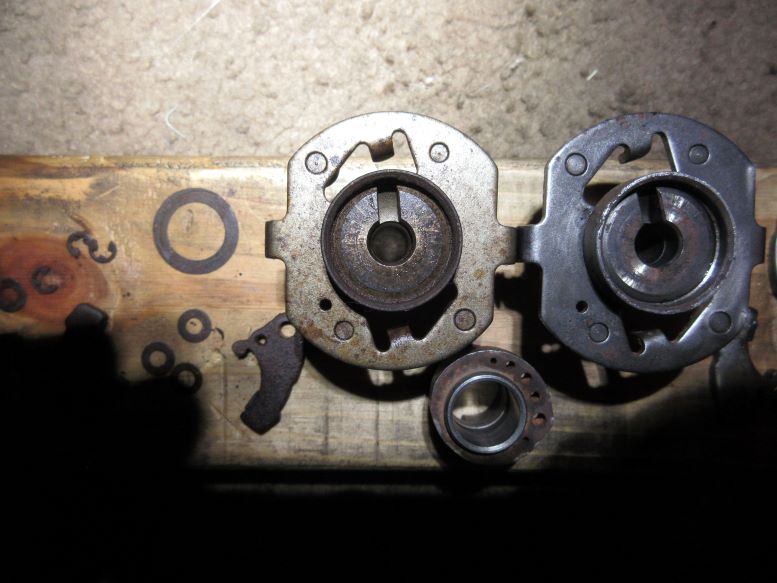

I had parts from a 1016 and a 1013 from the junkyard to make one working 1016 unit. (2nd pic shows the different keyways)

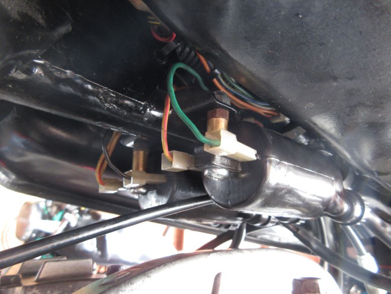

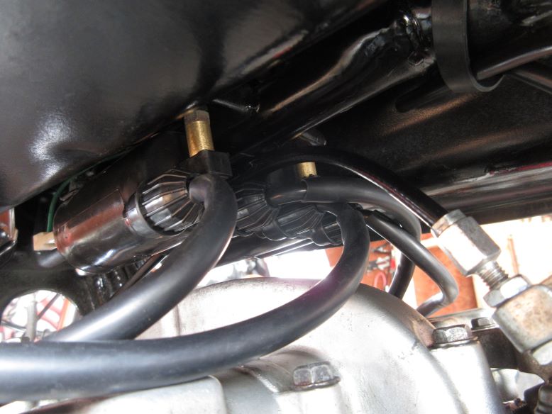

My coil wiring is (L green red / black red R) and plug wires look correct @ 2,3,1,4

Plug wire order is largely irrelevant - one coil triggers cylinders 1 & 4 together the other triggers cylinders 2 & 3 together. If it starts better by flipping the rotor is sounds like the black and green coil wires may be crossed (you will still need to fine tune the ignition timing) probably best to stick with the advancer parts intended for this bike as trying to compensate for the different keyway position will mean you need to extend the slots in the back plate to get enough adjustment.

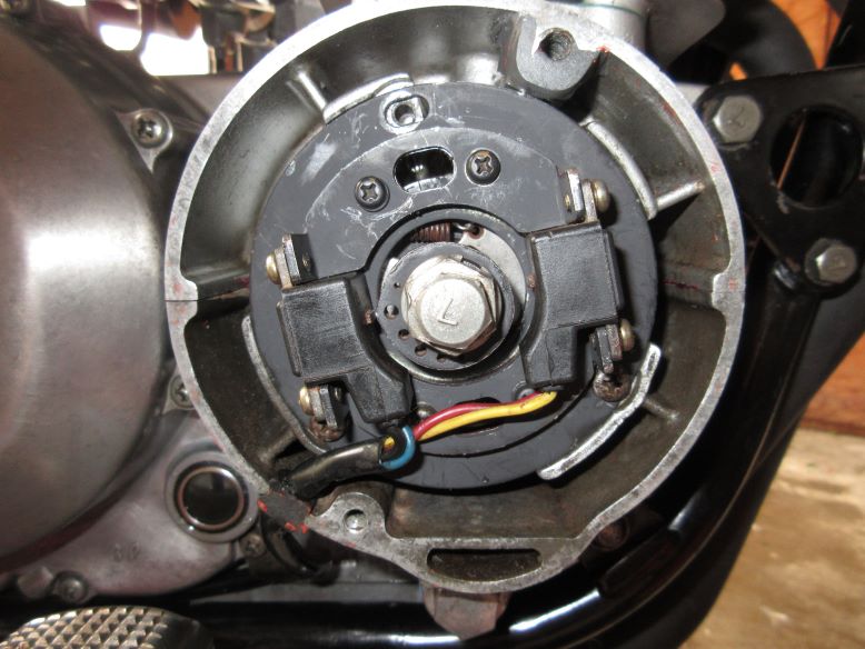

Another point to consider, the pic you posted shows the rotor aligned with the pick up at TDC so it’s firing after TDC, shouldn’t the static position be dirt against the 1-4 mark and not TDC ?

Tried flipping the Left side green, and the right side black wires and it starts up as it should. with the ignition wheel setup as it should be. Dont know why. The coils are labeled L and R from last time I ran the thing.
There is no adjustment with the timing advancer/rotor. There is a keyway and it only goes on one way, nor is there adjustment in the pickups. The only hole that is oblong is the top one with the screw missing. The other 2 holes are not oblong.

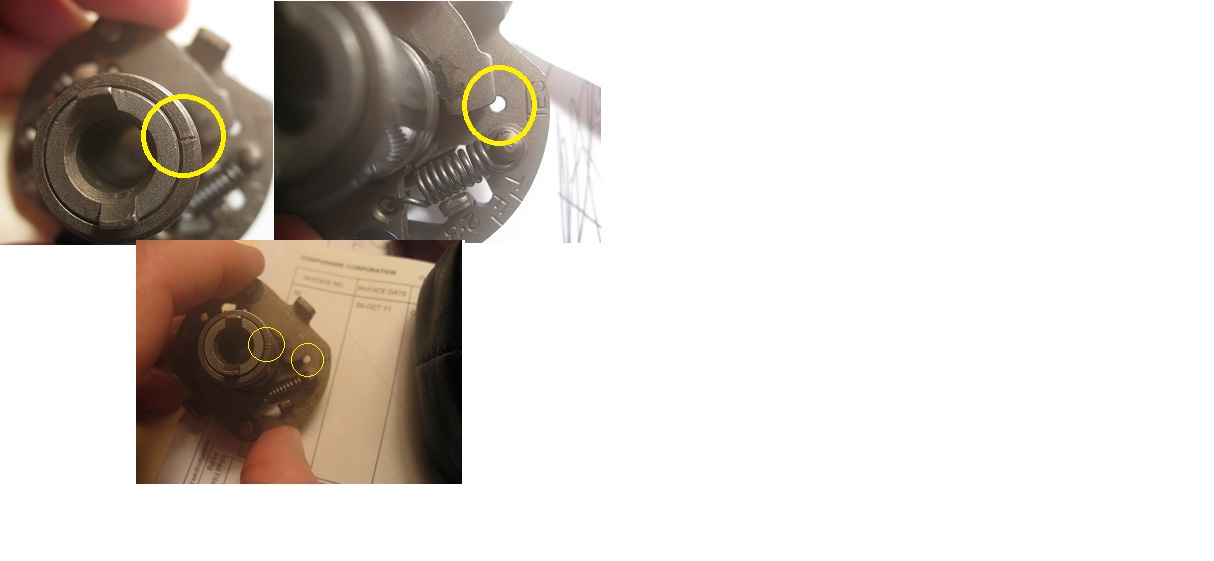

Did you disassemble the pickup plate, and its magnets, and did you note the orientation of the magnets that are sandwiched in between?
I had exactly the same symptoms that you are experiencing, after incorrectly assembling the magnets.
The are 4 possible permutations, of magnet position and orientation, and only one that works. I had flipped one of the magnets over.
By looking closely, I could see witness marks on the plate and magnets and subsequently got the magnets orientated / assembled correctly.
Also, the screws that hold the magnets MUST be Brass... I assumed that the brass screws were used to mount pickup coils... ask me how I know!

Yo. Some light at the end! I had my New (used) magnet plate disassembled to swap parts around and prime. I rebuilt it according to the little white line that was on the OLD original magnet pickup plate. I placed them in the same orientation, but they may be different. Its gotta be this... THANK YOU ahead of time for even the suggestion. I didnt even consider it!
