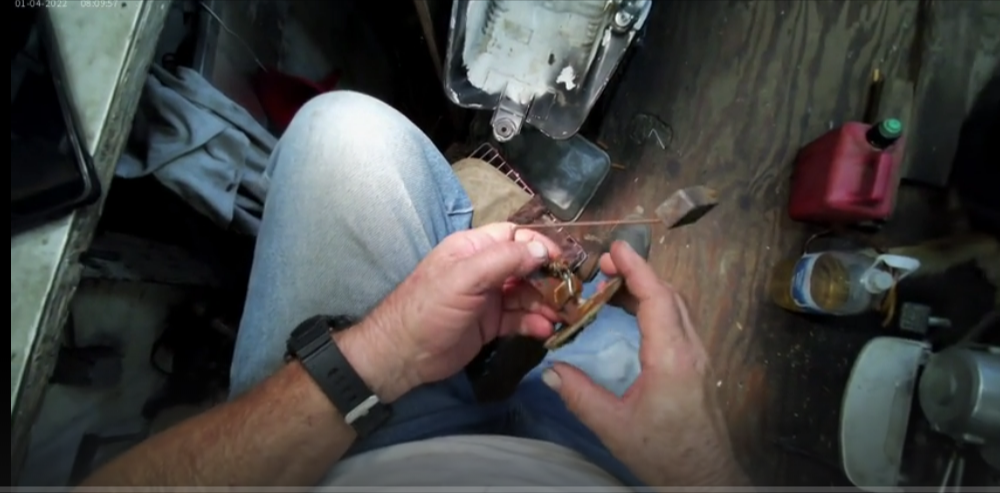

It's OHMs. If AMPS it would become a heater. I had to repair this one.
rumble.com/v5aw6ec-kzp-fuel-sending-unit.html
