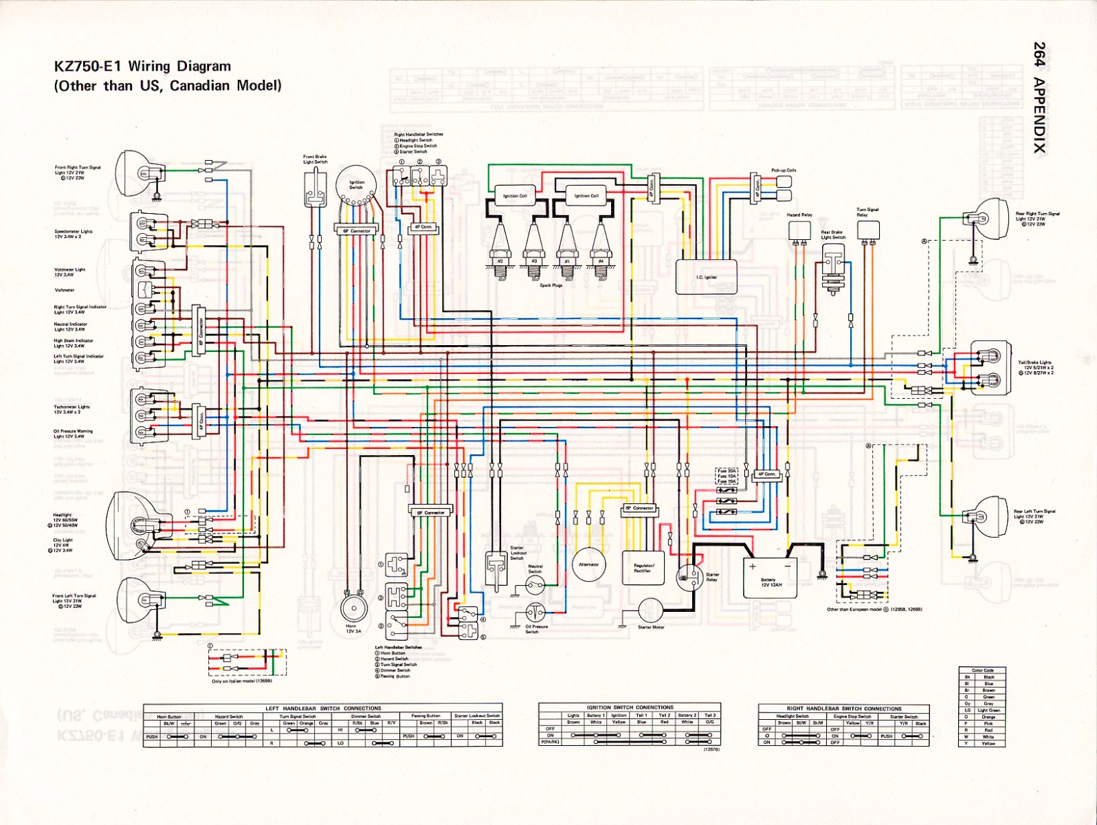

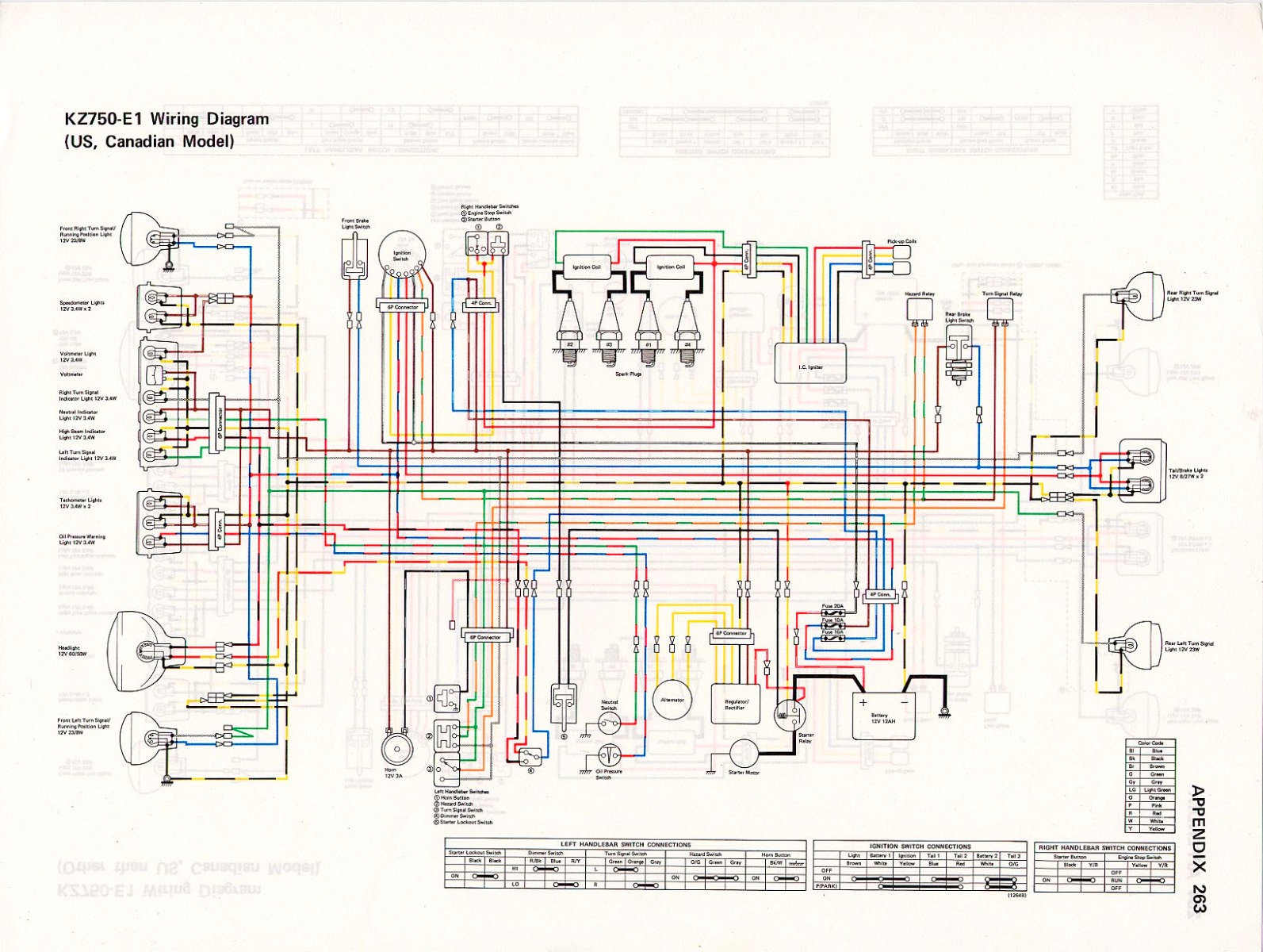

Hi all ive owned this Z750 e1 for 20+ years and only recently got back to working on it , a few months back I got it to run , but since then haven't had much time unfortunately, I was stripping back the wiring to fit a different headlight speedo indicators etc and had everything working! But since then ive somehow lost the plot and cannot figure out were this black wire from the right hand side control goes to , looking at the manual could it be part of the start switch? If so I cannot see a similar black on the loom?
aAlso the clutch engament swith wire thacime from the clutch lever 2x black wires cannot see were these go .

The black from the right switch goes to one of the blacks on the clutch switch, the other black from the clutch switch goes into the loom to the starter solenoid

You indicate you have a manual, it should have a wiring diagram in it, but if not here are 2 one for the EU and one for the US.

Hi thanks for this yes I've got both the clymer and the haynes, both are in black and white and its hard to trace the wires , the colour will make it alot easier, thanks both for your help, I'll get back to it next week, once these work shifts are over and will try again.
